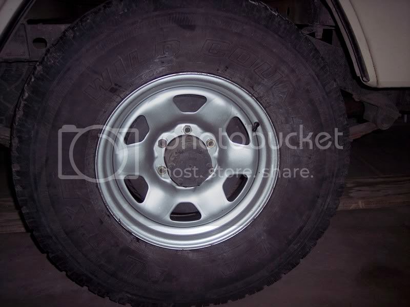

Here are some 70 series wheels courtesy of CruiserDan...I ordered these for my 80, but it's been at LC Engineering (They are using my supercharger to get ready to start production of them) since they arrived, so I put them on my HJ45. There not black, but thats easy.
Good looking wheels. What are the dimensions on the 70 series wheels, and what did they cost, if you don't mind me asking?

16x7's. I bought 7 of them back in october. I honestly don't remember what the price was, but Cdan got them for me.
I thought those wheels were like 16x6 or something...? Any idea what the backspacing is on them?
I might have to get rid of the Uniques I just bought and try to nail down a set of these. I really like the looks of 'em!

Ok...ASHOOTER was right. These are 16x6, so I guess they don't fit your bill.
Shooter was this the picture you were talking about?

That's the one. I LOVE that truck!!!
