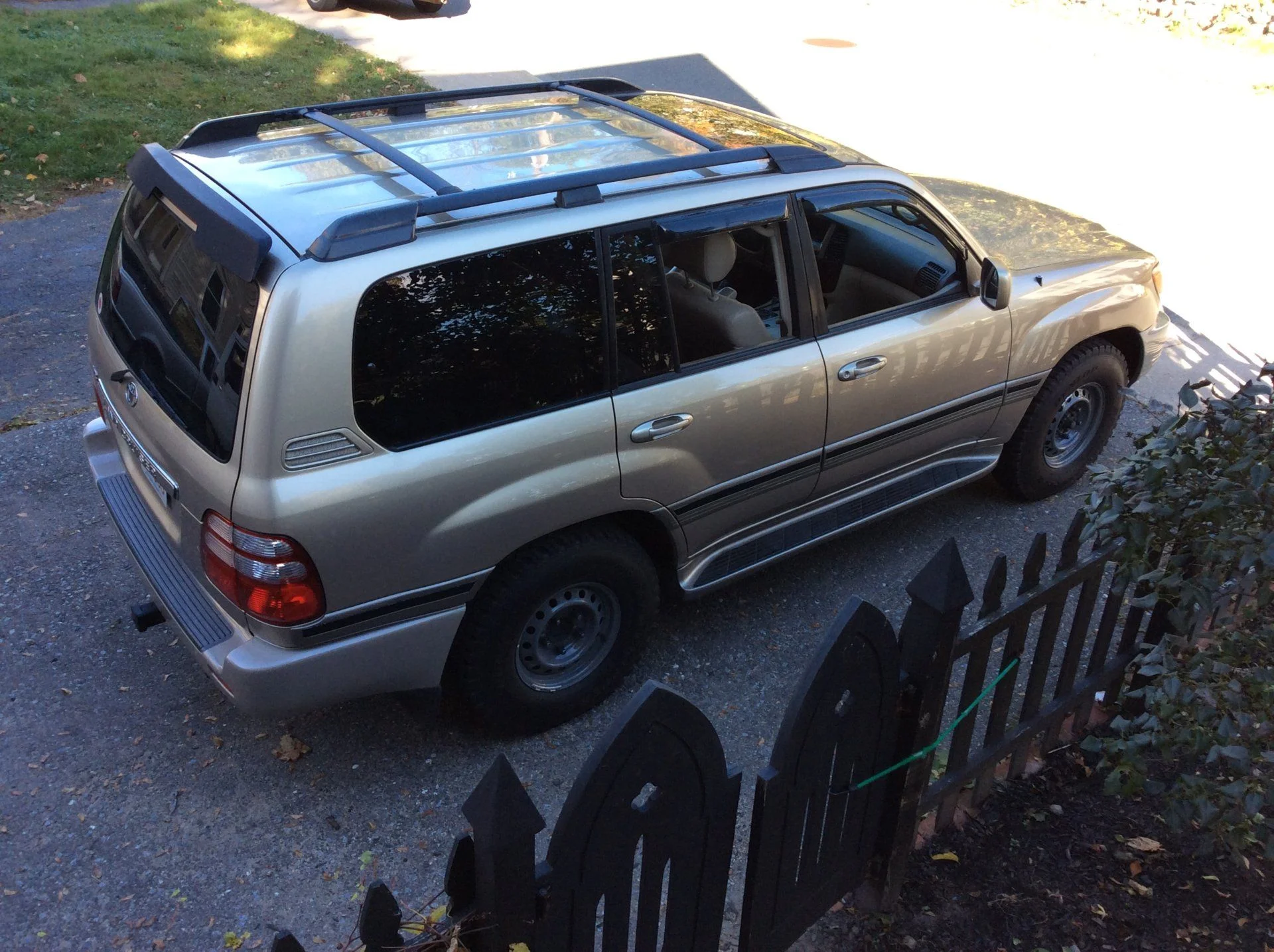

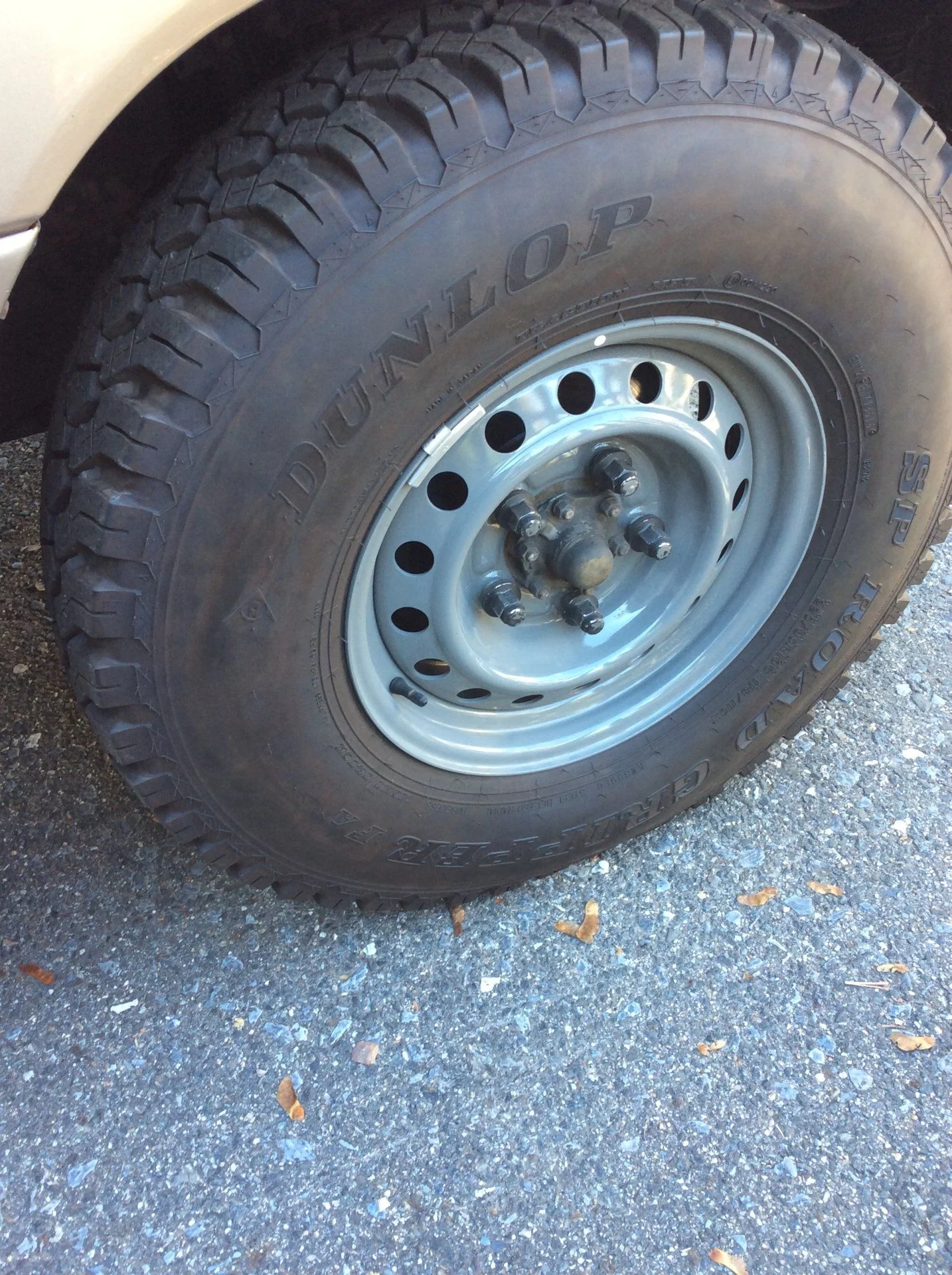

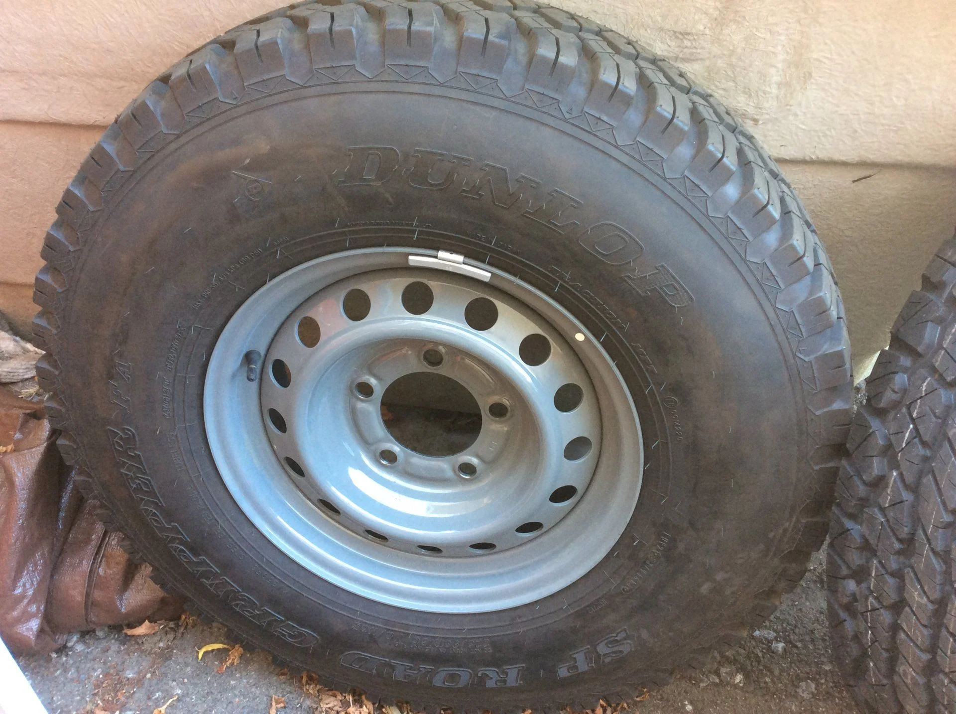

Factory 16x6" steelies? Yeah, we have those... These are for VDJ79 trucks, but they look like they might work well on the 100 Series.
What size tire and model Dunlop tires on the wheels in the picture?

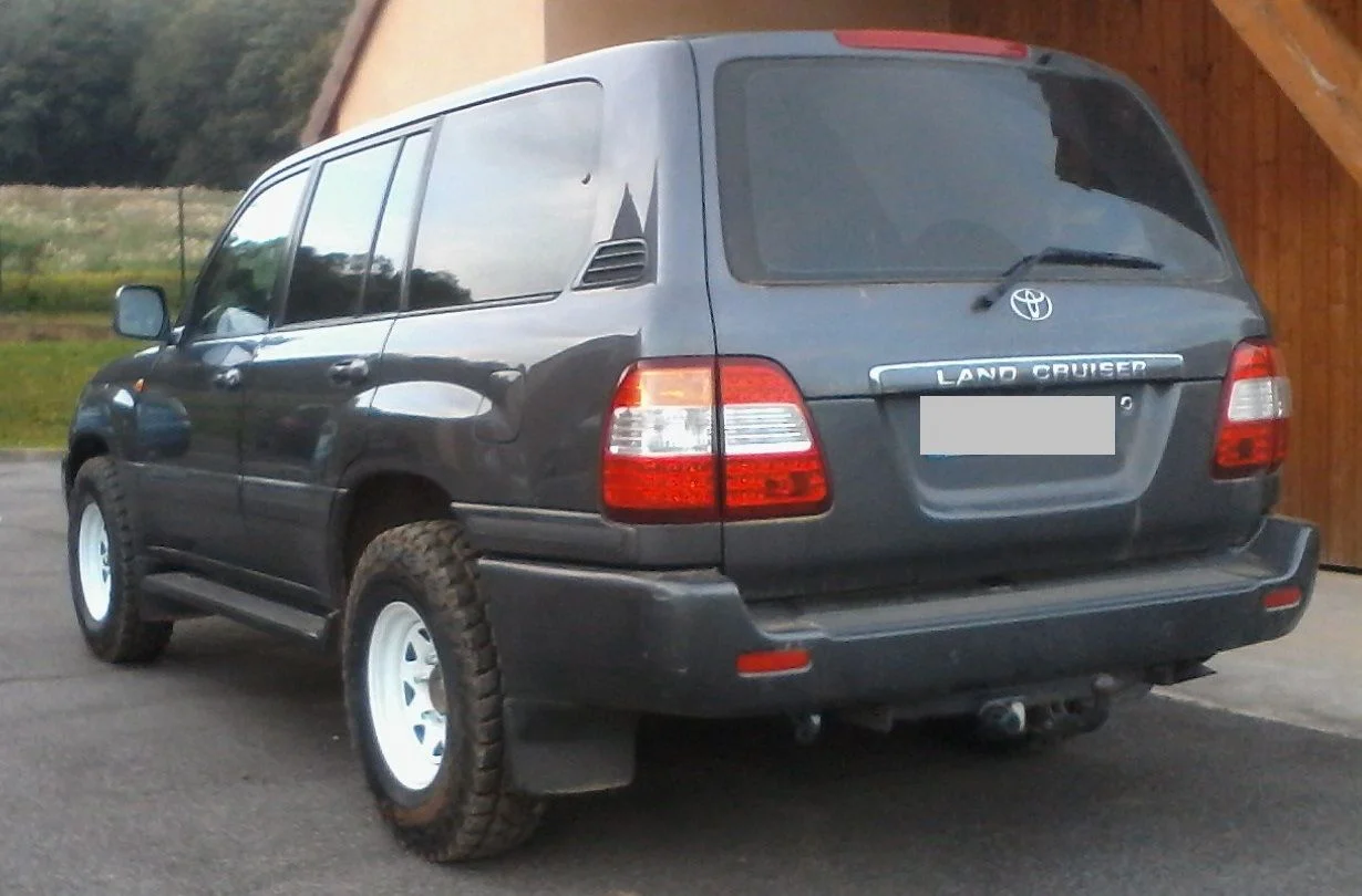

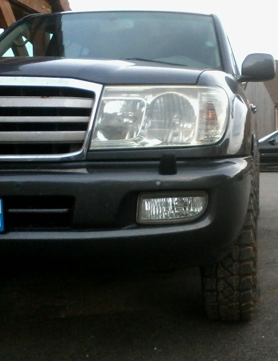

If the et is 0 to +10 they will be good on a 100, i have 7x16 et +05 and that is the max one should go for, my sidewall are slightly out of the car body on 238 85r16

Ride is great, but largely due to the tires them self, This MT51 are great, very sticky tire, excellent grip even on wet roads. Steers and track perfectly well, better than with my oem wheels with goodyear allweather.
You can feel the added weight (36kg with rim vs 31kg for the oem 18inch 275), of the tire on acceleration at 80kmph the lockup tend to pop off a little earlier than it use to with the oem 18 inch tire but not by much and much less than it would have done with 265, not to talk about 285 and bigger.
The sand driving and testing i did, did not show any real differences to my lc80 on 265 75r16.
Very happy with this tire

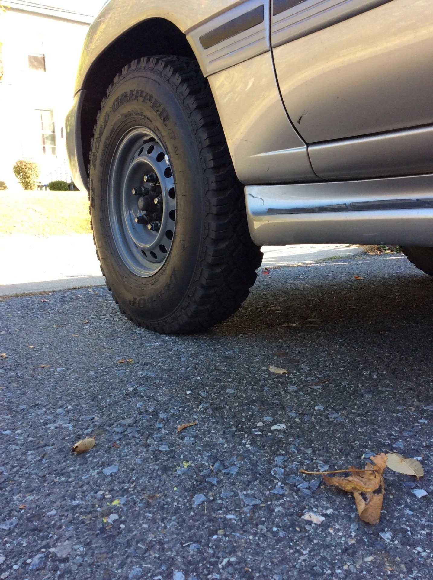

These fit the 100 very nicely. The offset places the wheel just inside the fender.
I'll get the weight as soon as some dismounting takes place.

I just changed from 285/75-16 to 255/85-16 in Cooper ST Maxx. It's a great tire and size for the 100. I'm very happy with the new size.
I should add that the tire/wheel combo you have is awesome jowett.
@bjowett How is the ride with the Dunlops?
