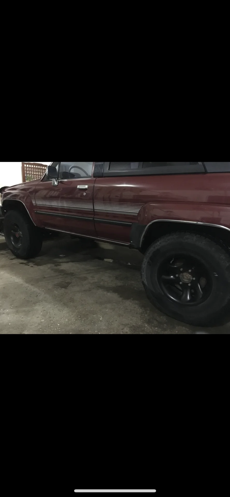

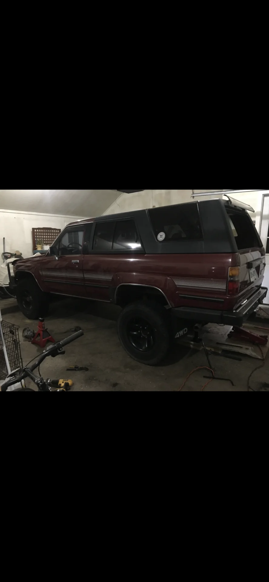

I was inspired by this thread also! I ended up not doing the narrow rim, although the shop I go to said it wouldn’t be a big deal. I purchased Pacer Daytonas 15x7 with 33’s and an OME spring/shock, took out one leaf on the rear spring. Still love the narrow rim look!!

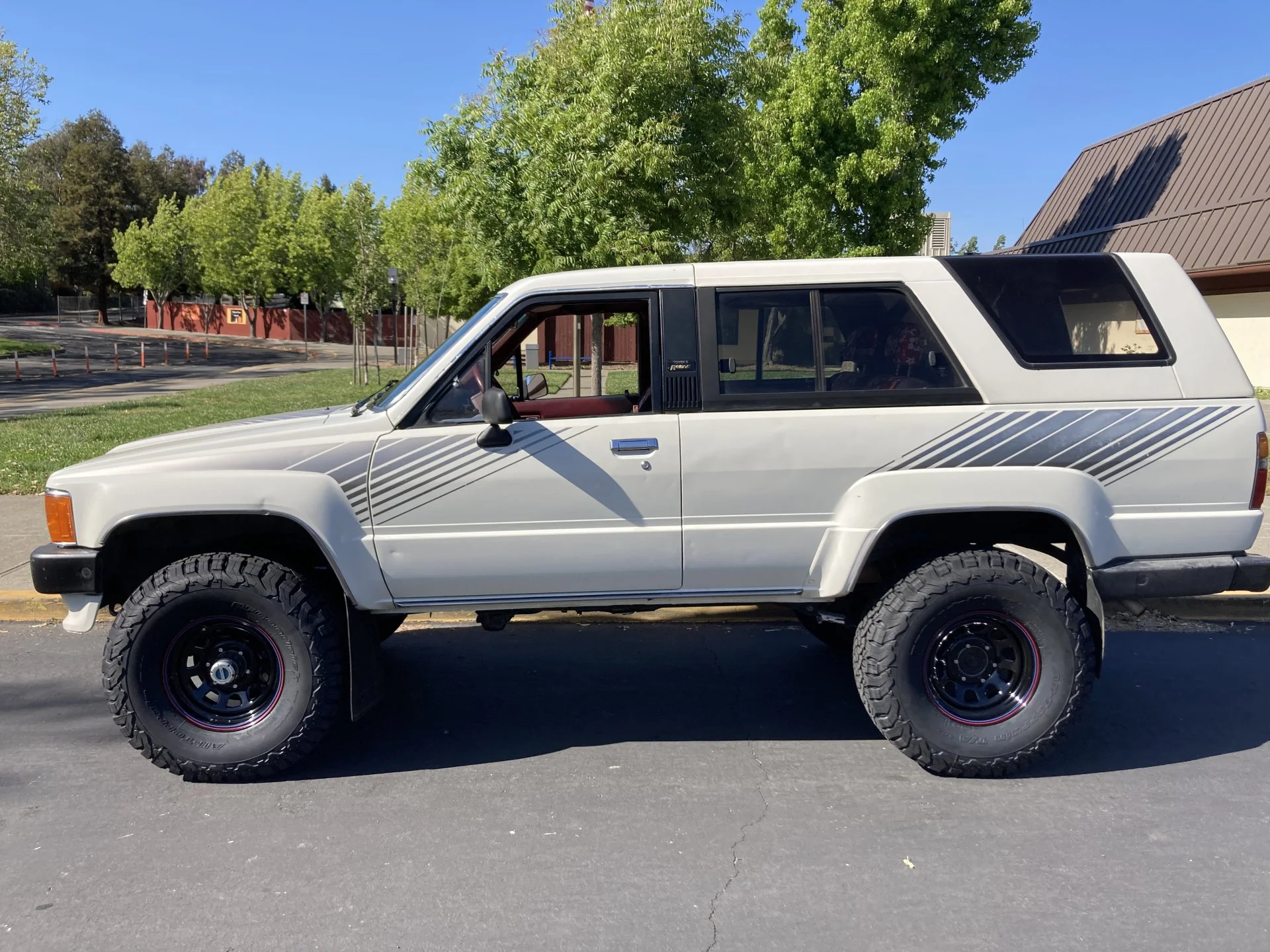

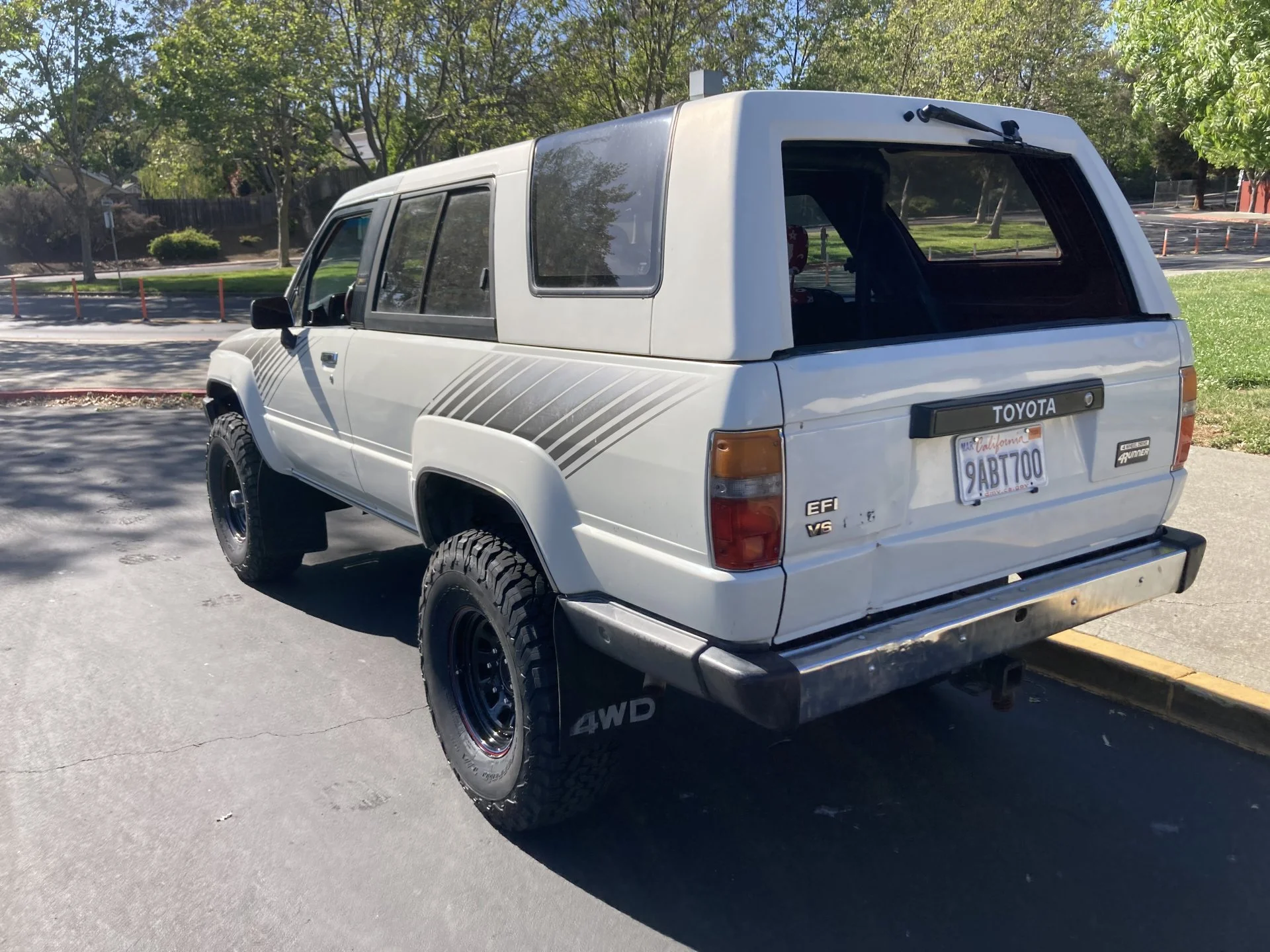

I never thought of removing a leaf from the leaf pack… Long story short I’ve got an ‘89 IFS, threw on some 2.25” OME leafs in hopes of leveling out the sag in the rear, went way too high. Want to keep front end stock so either need to remove a leaf from OME leaf pack on each side or need to go back to stock leafs with add-a-leaf. Which leaf is best to remove when removing a leaf from the spring pack? My goal is stock up front with the rear sag fixed. Before and after the OME 2.25” springs below in pics.

I did not use any spacers. I replaced the torsion bars with ome, including the ome shocks, and removed one leaf from the rear. The torsion bars are lifting the front. They work by “pushing down” on the FS. My understanding is ome makes two different rear springs, a “normal” and a “heavy” for carrying more load. I have the “normal” when I first put the rear springs on it was crazy high in the back! Taking out the one leaf is perfect. Before I did the lift I replaced most of the front end including the t-axles (which you can get rebuilt) So far everything looks good and I don’t think a diff drop is necessary at all.
