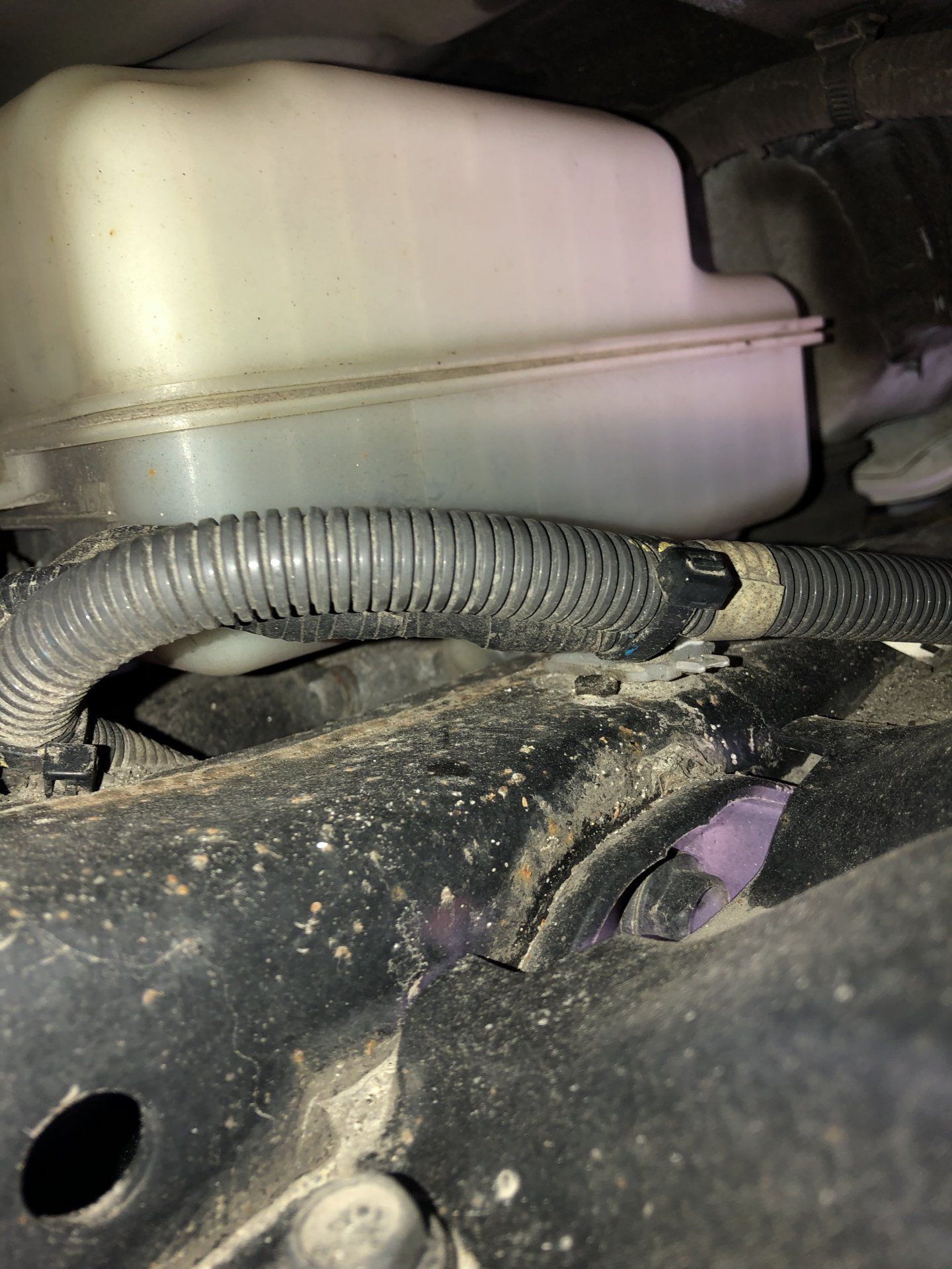

This is what it looks like right now...in HIGH.
Do I need to drain some or what are some bad outcomes for riding with too much in here?
My understanding is that there's no harm in having too much fluid. (So long as the reservoir is not bursting at the seams when the truck is in LOW height.)
So now I'm paranoid...and wifey is accusing me of f'ing up.
Tomorrow plan is to hand vacuum some fluid out of the reservoir.
Its in H mode right now...so I guess I need to take out fluid until it is at "MIN"? Then cycle down to L...and hope the liquid line shows "MAX"?

As they say, "Keep calm and carry on". I think you're fine, but Per FSM, you want to be at Max when you're at Normal height.
If I were you, I would bleed the 5th accumulator or the passenger rear to lower the level if it's really bothering you.
Drop it in low, bleed a corner and then back to normal. No need to overfill, just stay between the marks. You’ll be fine!
