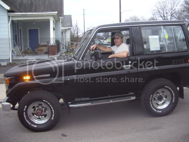

Forget an engine swap if you're looking to come out ahead on the cost factor. I think the 1st gen 4runner is around 3500+ pounds. My Bj70 was around 4100 lbs.
Hilux, nice 70! Who's the lucky owner?
