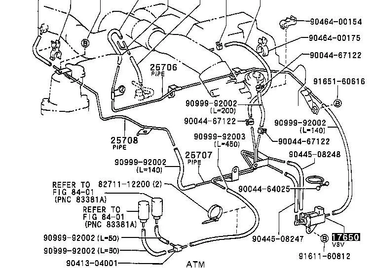

I have the FSM, and the best diagram I can find is on EM-45, and it still doesn't give enough info. The vacuum system has been fiddled with by the PO, I'd like to get it back to spec. I'd really appreciate if someone could take some pictures for me!

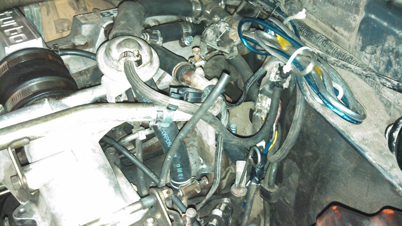

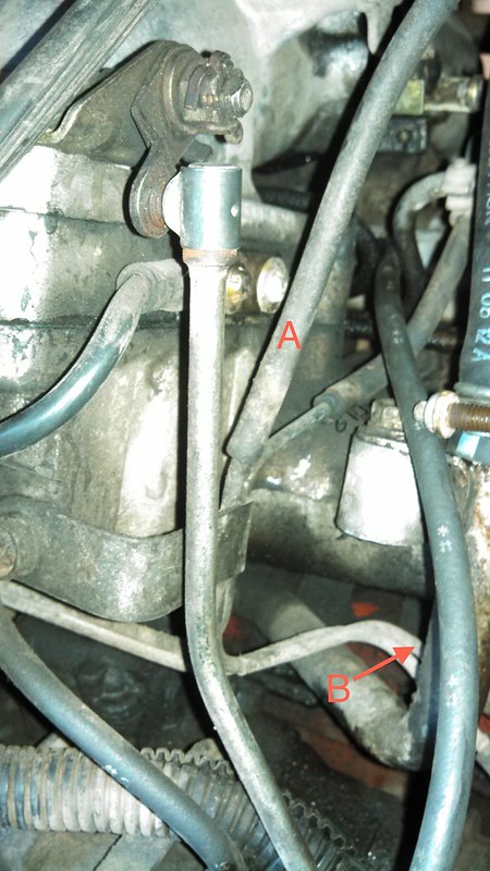

Thanks for the diagram. From what I can tell, my VSV is plumbed completely differently. I can definitely tell its been messed with. I will post pictures in a bit.
VCV by dtpaladino, on Flickr
Hard to tell from the image, but the valve is plumbed directly to the VCV and the two other vac lines to the vcv are plumbed behind and under.
So why the disconnected hoses? Is that length of vacuum hose just bypassed? My vcv is working, although the wiring looks awful.

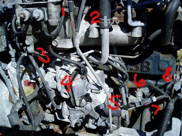

Here's a pic of the stock set-up.

Vacuum from the pump is applied to the 'back' of the VSV.
When the VSV is energized the valve switches the vacuum to the air-shutter pot on the crossover, opening the shutter so the engine gets air. When the VSV is de-energized, the air shutter closes, and vacuum is switched to the [STRIKE]terminal filters [PNC83381A] located in the fenderwell[/STRIKE] the air intake.
The VSV is normally mounted on the engine block as shown at #7 in the pic. This is an unreliable location that gets a lot of heat, vibration and often water-spray. On my truck, when the original VSV failed, I mounted the new one at a higher location on the firewall by extending the #8 hose which connects to the vacuum pipe behind the engine.
The VSV on your engine has been relocated too, with a direct connection to the air shutter bypassing the disconnected lines.
An easy way to disable this engine for security is to switch the two vac-hose connections to the 'front' VSV ports.
Thanks for the image John! I figured they had been bypassed.
