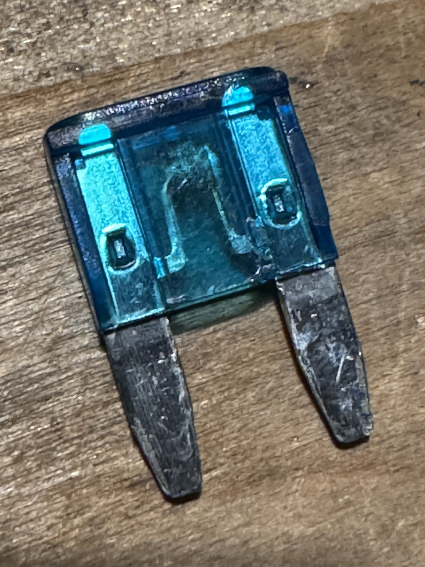

Oh you guys are going to love this one. What’s the first thing you check when an electronic device stops working? You check if the idiot troubleshooting knows what a burned fuse looks like.
Yeah, all the easy stuff is ticked.
👆No it wasn’t you moron.
Just hope whatever popped that fuse isn't chronic and a hint of a bigger electrical issue.
It was only a 15 amp fuse and I've been running my fridge off it so I'm sure that's it. I over wired it so it should be able to handle 30amps at that length (14g) so I'm guessing it's from running the fridge while it charged the fridge's battery (My old fridge had a built-in). Its also wire loomed the whole way so I figured it was safe to stick a new one in and see if it happens again.
