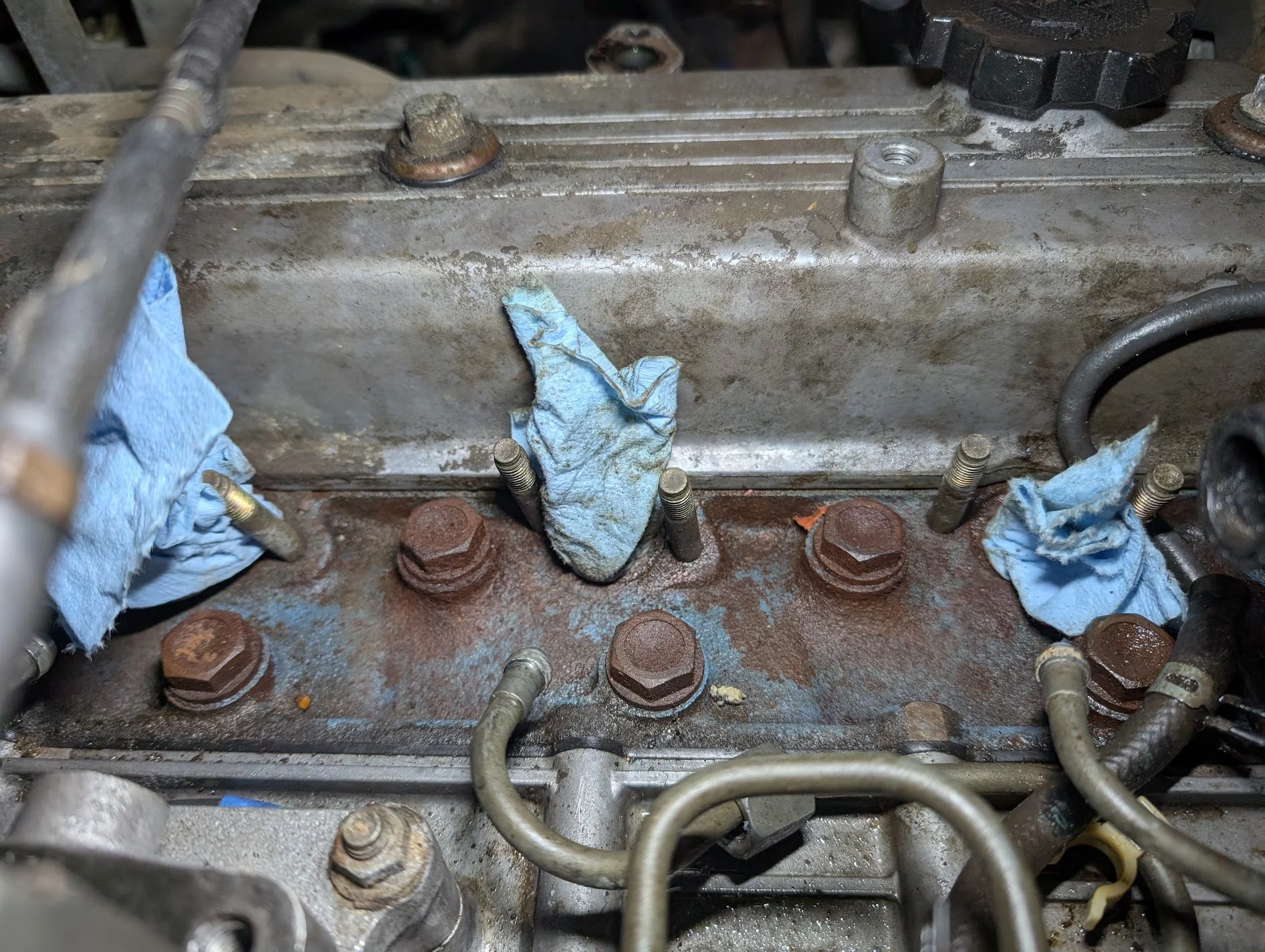

I pulled the injectors today. Glad I did, looks like they've been in there a long time. Some of the heater hoses have seen better days so I'll be replacing those before reassembling everything. I also saw a lot of oil in the turbo pipe so will be pulling the turbo for a rebuild.
The head bolts around the injectors are looking a little crusty. Should I do anything about this? Fluid film them to prevent additional rusting?
