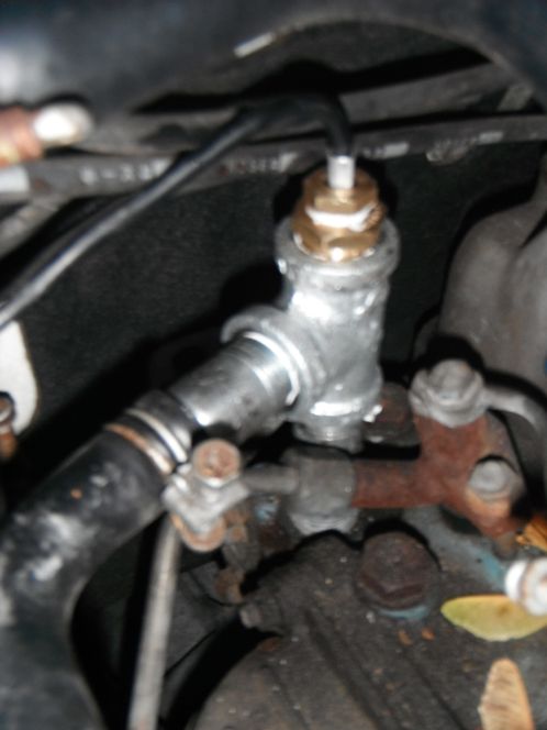

This is where I put mine :
... on the rear hose heater outlet. To have an accurate read, I have to put and left the rear heater valve to ''high'' to ensure a constant flow. My readings are the same as DanS HJ-45.
