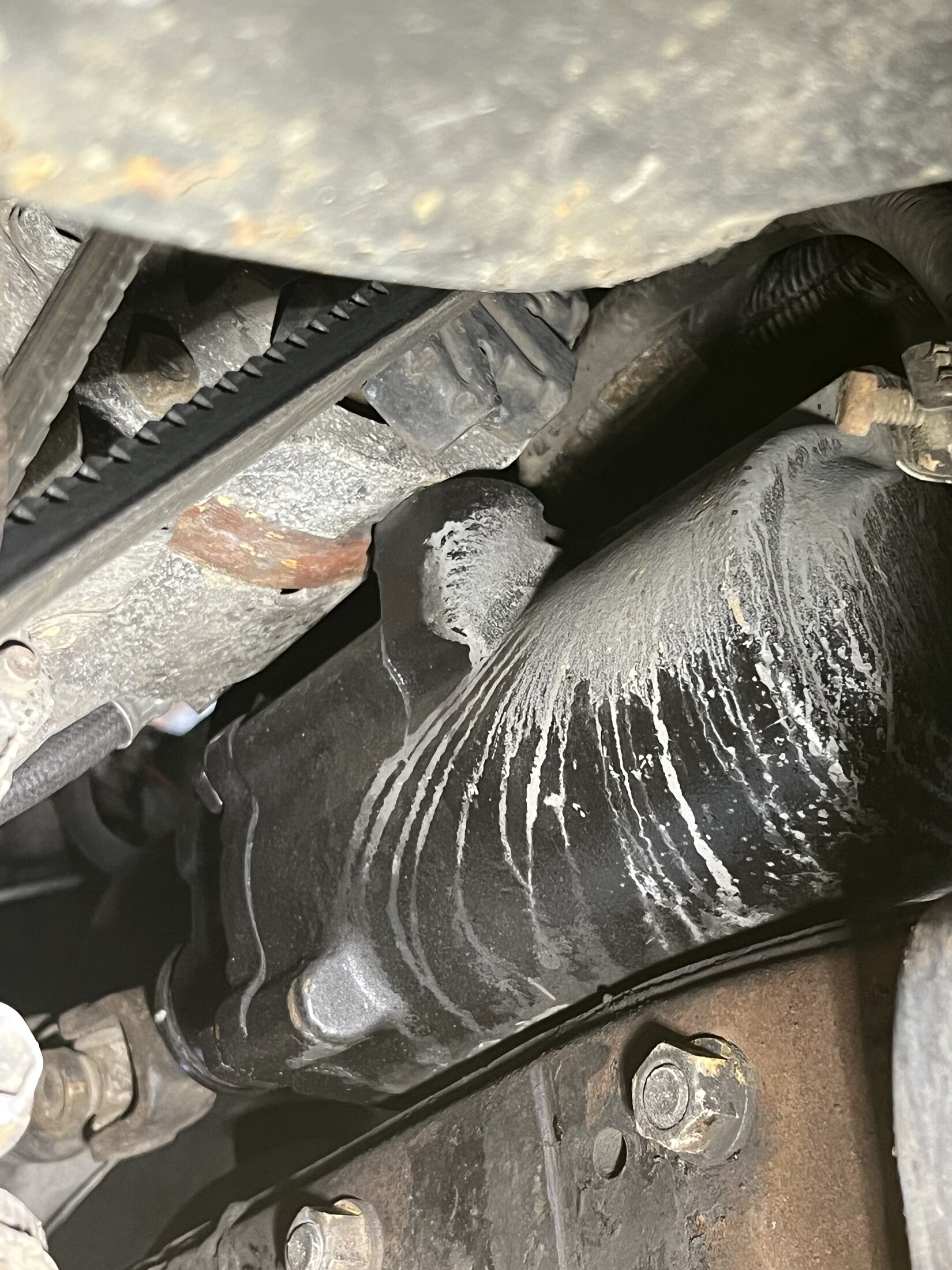

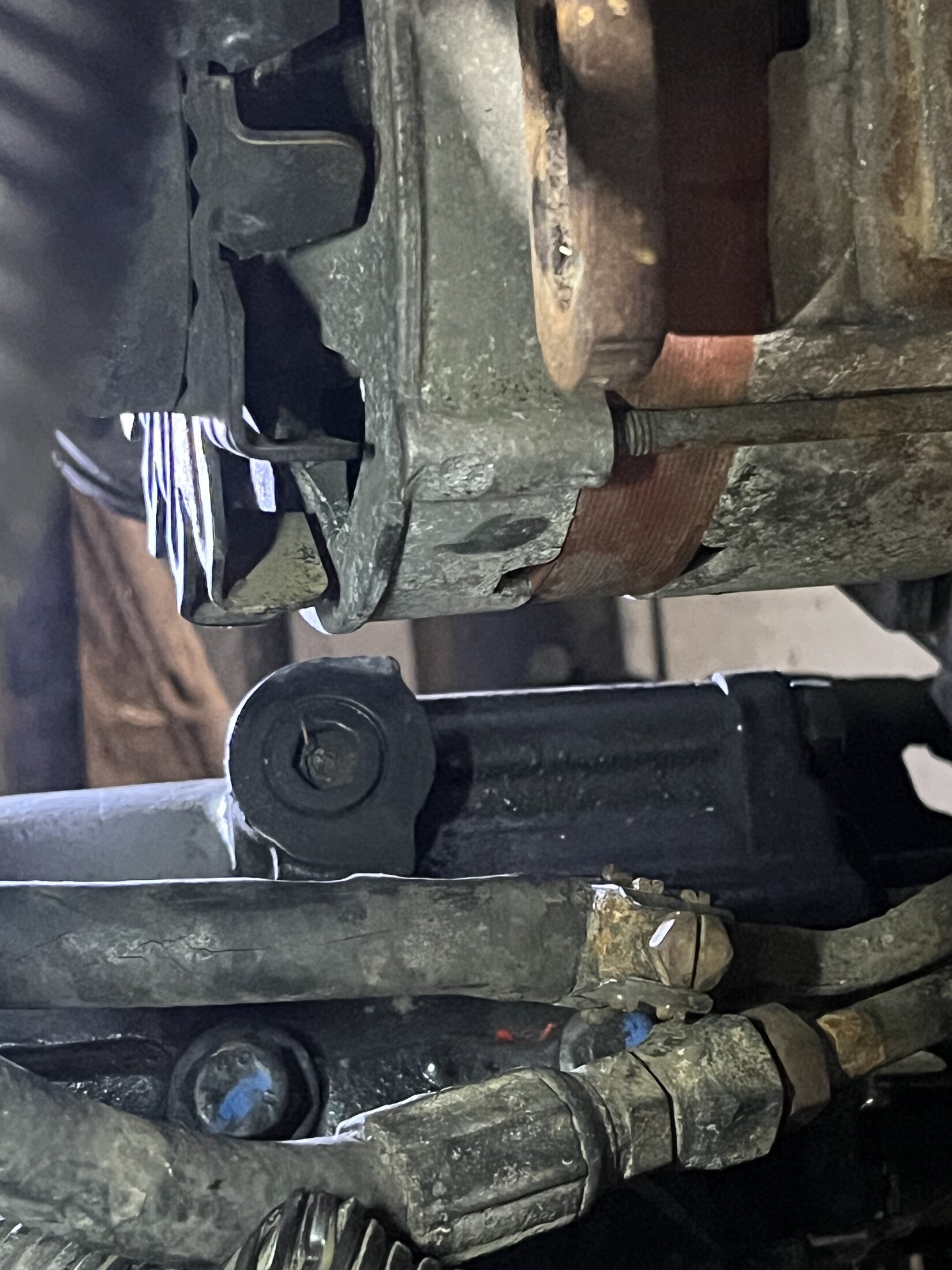

I solved it and it was the 80 box…the 80 box has an extra “ear” that the 60 box didn’t and in my case I had an old alternator belt that was stretched enough to let the alternator sit on the steering box and make the vibration that was driving me nuts. Pretty crazy find:
