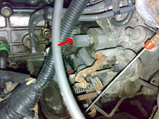

Here is the instructions how you can adjust 12h-t idle properly. This is fairly common problem on 12h-t. Sorry my bad english, but lets try.
Behind that big covernut (big arrow) is idle speed regulator screw. Turn it open. Then idle speed adjusted its own screw (little arrow) 700 rpm. Next tighten the idle speed regulator screw so the idle sets approx. 750-800rpm. Then rev engine and look that the engine is not stall. If it stalls, then tighten the idle speed regulator screw little bit more (big arrow) and lower the idle (Small arrow), and thats it:popcorn:.
I'm also having the issue that the rev's drop below idle when coming form higher rev's. It is to my opinion caused by the fact that internal wear in all the linkage arms makes the reaction of the pump too slow on it's idle setting. The adjustment you suggest will increase spring pressure on the idle controller, effectively increasing the gain of the controller. This might work, but when I tried it made the regulator unstable. The engine was getting nervous on it's idle controller since the increase in gain (P action if translated to a PID controller) makes it unstable.
I learned to live with it. Idle rev a bit higher to compensate this effect a little. Only proper solution is and injector pump overhaul I believe.
