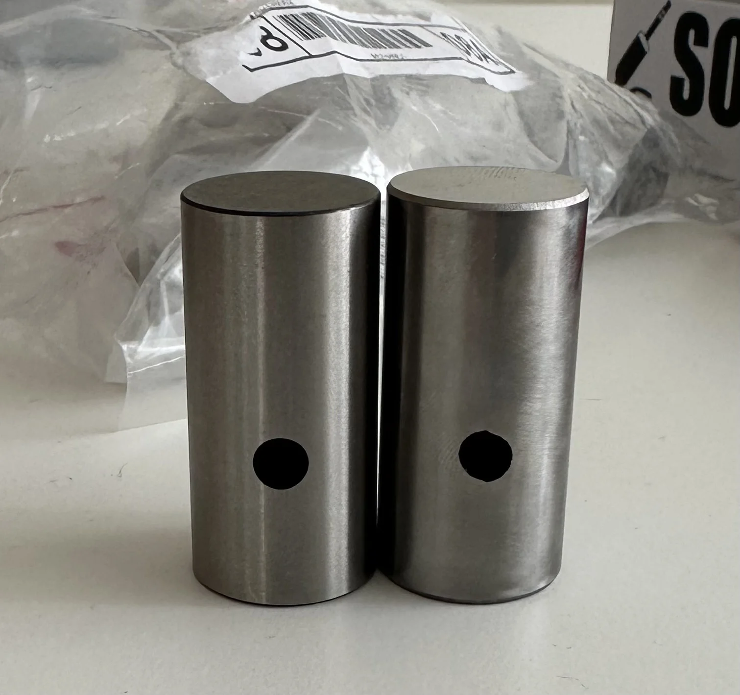

A friend of mine suggested lifters. This was an interesting journey. Im sharing my sources for getting lifters. I could find a few from some different parts vendors but couldn’t find a whole set. Turns out 2H lifters are the same which makes things easier because there are 2H forklifts in the USA and fork lift suppliers carry them.
Toyota part number
13751-47011
