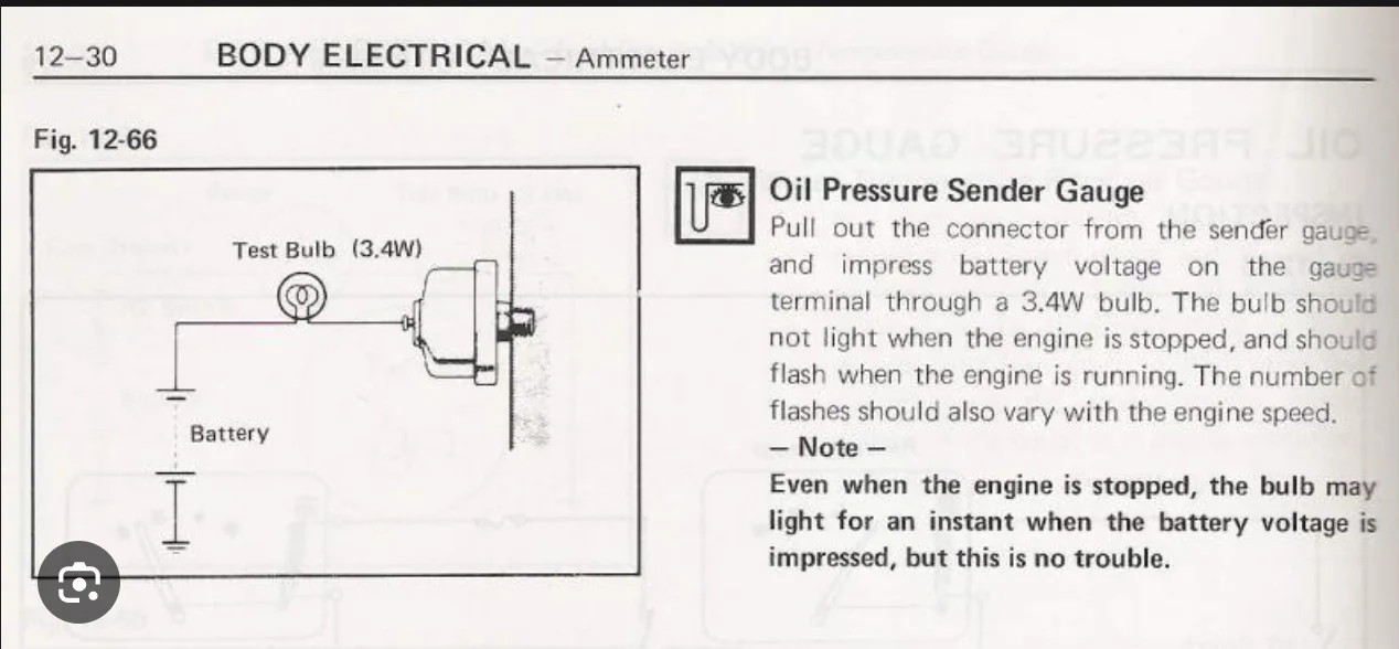

the fuse would usually be labeled gauge fuse.
have you verified your wiring is good from the point of the gauge to the oil pressure sensor have you done a continuity test?
have you tested your oil pressure sender?
Thanks for the lead V.
I have a brand new sender installed (83520-60020). I have not tested via the light method, I'll need to find a 3.4w bulb.
The only fuse in the fuse box that would be close is labeled "Engine"....and all my other gauges work....unless there is a relay/fuse on the wiring harness elsewhere?
