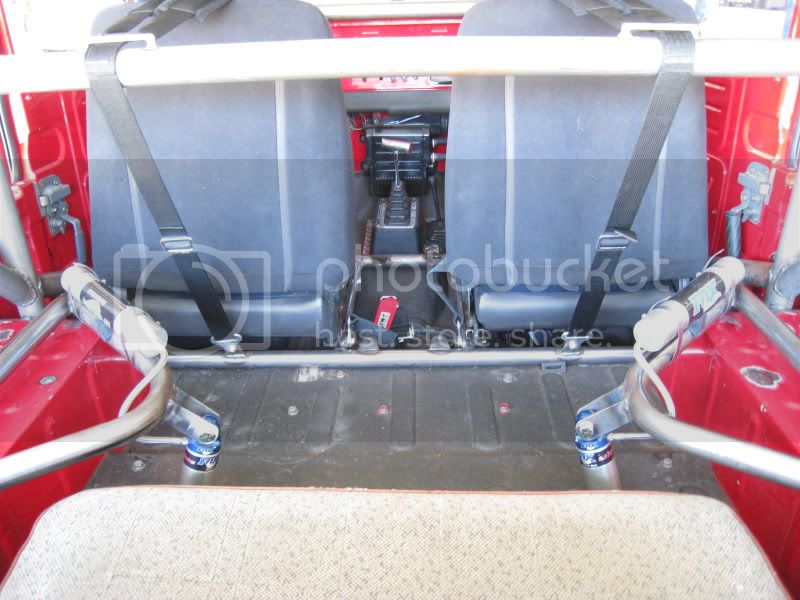

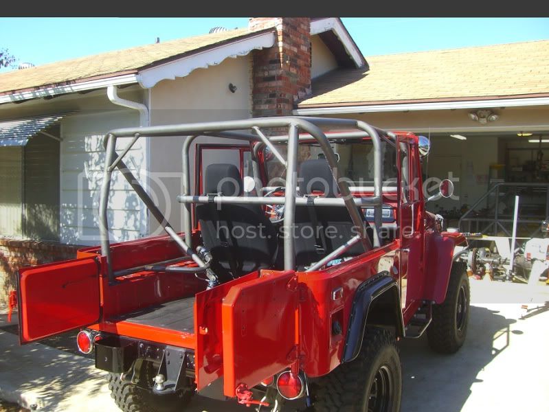

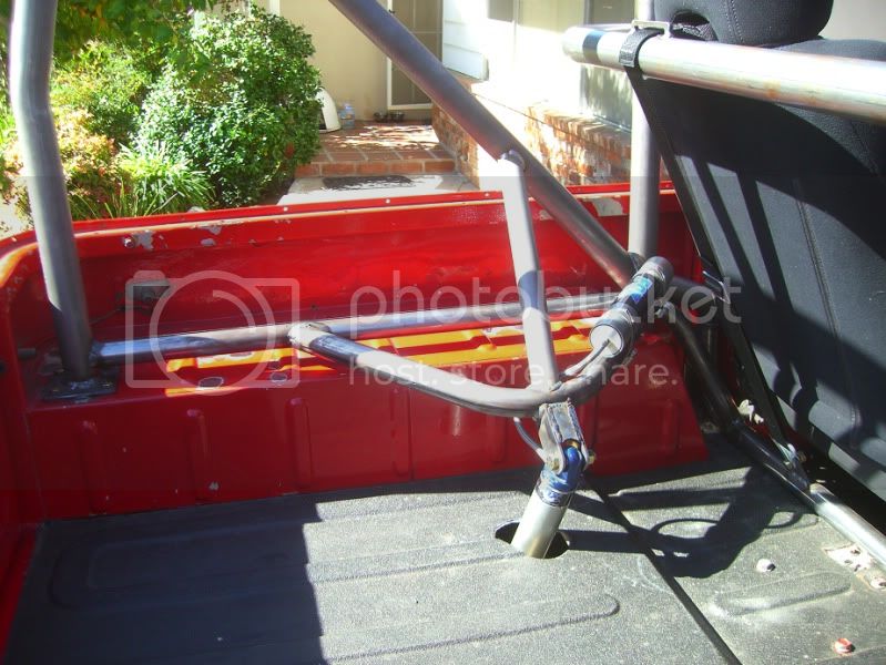

The only problem is that these shocks are 19" long compressed and 31" stretched. So i had to make em work. I built a shock hoops on the inside of my rollcage over the fenders. And I had to cut holes through the floor. Didnt want to but I did.

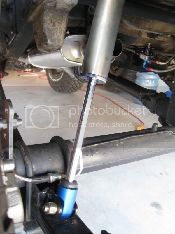

On the axle I cut the original stud off the perch and welded in tabs.
Here are some pics.
I still have to add some supports on the hoops because they flex. and I will box up the tabs on top.:cheers:

Looks like you made the back seat unusable. :meh:
It does look cool though, It will be interesting to see if it flexes better. Any reason you did not mount them strait up to come through the floor just inside the fender well to still have access to the seat?

It might be a good idea to put a vertical bar from the shock mount point up to the roll cage. It will add a significant amount of rigidity to the shock mount and make it suitable for air-shocks in the future.
Leni
Looks good , but like everyone else ? Limits your back seat use? Can you come up thrugh the fender wells? Maybe use the hoops you made just up and down not laying down?
The reson why I mounted them there is because the frame would be in the way if i tryed to make the shocks more vertical mounting them in the same stock location(above the spring pack). This is the least amount of angle there could be and the closest to the inside of the frame rails. When the shocks are compressed they move closer to the frame, thats why the holes are elongated in those directions.
As for being on the outside of the frame, I was worried that the tire might get too close to the shock body. I have disc brakes back there, so the calipers are in the way if I were to have mounted the bottom of the shock closer to the tire. But I did want my shocks to be as vertical as possible because they are more efficeint.
The rear seat is a novelty and its still usable, for one person, two if you wanted some lovin'.

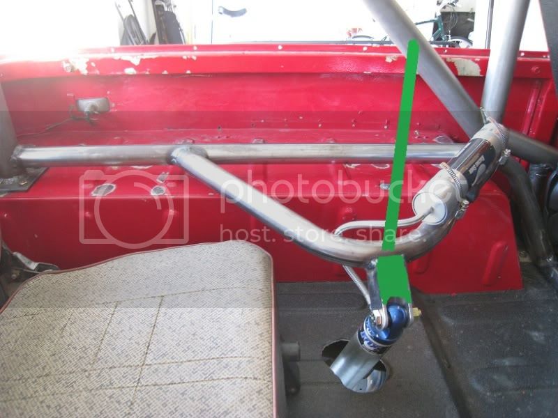

If i get some time tomorrow I will weld in some supports like toymanic mentioned. Something like this
That looks like a Lot of uptravel, looks like 80%up 20%down travel. Withe that high a mount you can go 14/16" travel shocks.
Looks can be deceiving. With the top back on and gear loaded up the shocks will be 50% up and 50% down, 6"and 6". I am going to lenghten the bump stops a bit.
It's pretty tough to use 6" of uptravel unless you're racing Baja. Try to get it down to 5" or 4" of up and the rest down.
Something like this
that's exactly what i thought it needed when i saw the first picture....i like it, and it looks like people can still sit back there to me anyway.....those are some nice shocks, if you ever decide you want to do a 4-link you should be able to keep that setup and shocks the same and just add some coil springs and links

What are you running for rear shackles? :beer:
Tim
The shackles look like Downey cantilevers to me. Some type of two part shackle like that atleast.
