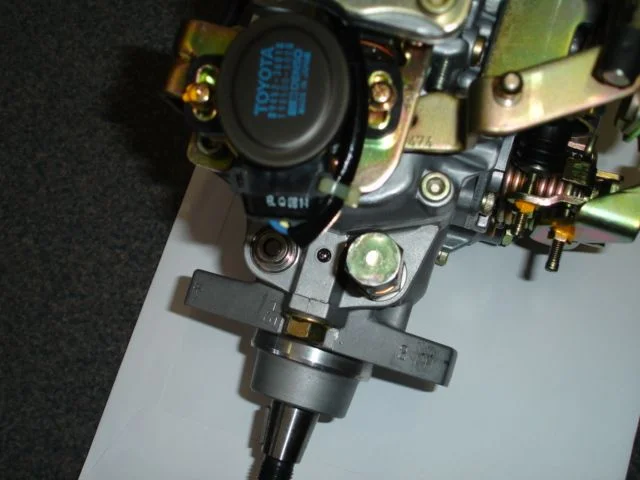

You will need a Diesel ECT computer and I am going to speculate, since I have not yet swapped an A343 equipped FZJ80, You may also need an ECT plug and harness stripped out of a 93/94 FZJ80. So that you can splice in the ECT computer in place of the Gasser Tranny/engine ECU.
If you can get the seller to fwd some pics, top of the injection pump will tell all.
It will look like this.
