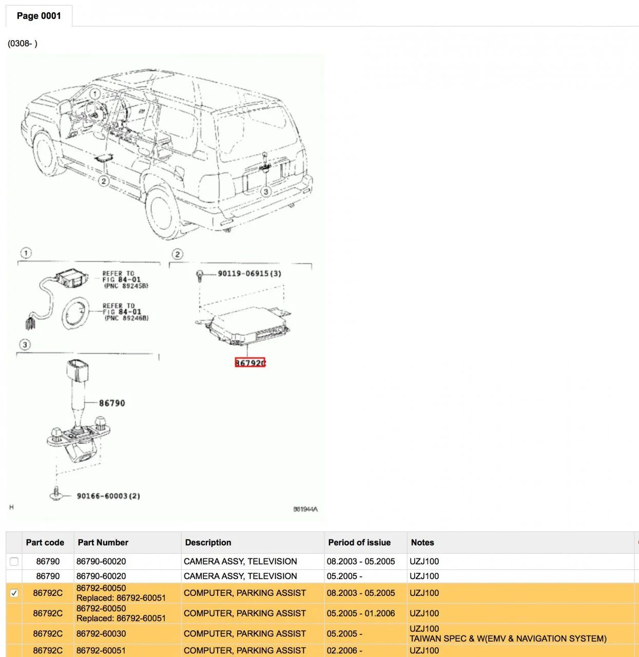

I see, a steering wheel sensor is tied into the system. But I guess it is only used for Navi and not the reverse cam.
Here's Diagram 86-06: REAR MONITOR DISPLAY & CAMERA
#1 is Steering Wheel Sensor
#2 Parking Assist Computer
#3 Back-up camera
Why would there be a parking assist ECU and no actual parking assist?
I would guess the "parking assist" ecu just manages the backup camera and possibly the input of the steering sensor.
