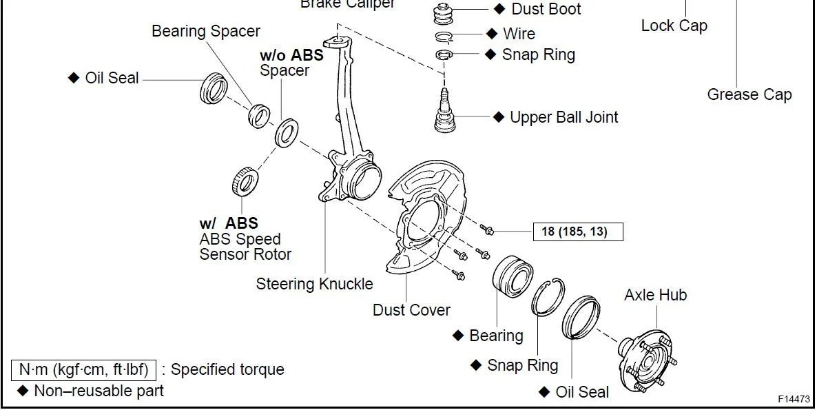

So, I’m embarrassed to say that I have replaced the same bearing 3 times now. Two different machine shops have pressed the new bearing and spindle into that. All three were broken and chewed up within a mile. I’m at wit’s end.
Is there a special way of pressing these in? Do you have to freeze/heat the bearing/steering hub?
Please advise. I’m sick of this.

Do you have ABS?
I may have an answer then. I broke a knuckle on my non ABS and ended up getting a knuckle from the junk yard. It was an ABS knuckle and had a sensor and speed ring inside that the sensor reads. I did not need this to function and I wanted a new bearing installed. I carried it to the local NAPA and bought their expensive Timken bearing and had their shop put it in. I took it home and install the knuckle. Got about 1/2 mile down the road and it's wobbling all over the road. Took it home and the wheel is flopping. Took it back off and back to NAPA and after a heated discussion they put a new bearing in. Take it home and reinstall it and it is doing the same thing again. Go back and lose my isht on them. I spot the shop guy and go harass him and he starts crawfishing. I ask him to show me the old knuckle and when he does there is the speed ring laying there. In the pile is a small spacer the same as the speed ring minus the ring. He explains where these came from and I ask why he did not put them in and I'm fuming at this point. I gather up everything and take it home. I install the speed ring on my garage floor with a 2x12, 2# shop hammer, and some random stuff to drive the races with. Probably close to 70,000 miles later and still rolling. The bearing was tight enough I couldn't wiggle it by hand even with the wheel mounted and no ring.
So, long story short, make sure there is a little spacer ring in there. Shop guy knew I didn't technically need the speed ring but neglected to realize I still needed the little spacer ring since it was an ABS knuckle. I've since bought my own small press for jobs like this. Hope this helps.
Edit: you can put the ring in from the back because, if I remember correctly, that's what the CV axle butts up on.

Holy s***, I think that you’re right. Problem is that I don’t have that spacer now. What’s the part number?
90560-52001 is the spacer part number. Same part number for both sides and fits ADD or manual hubs *without* ABS.

Forgot to mention I have ADD hubs but the diagram should give that away. I downloaded a zip file with all the exploded diagrams and torque specs but no part numbers. I used to be able to go to my local stealership with a printed copy and circle what I need but now that it's a 20yo truck they usually don't have what I need and act like they cant get it.
