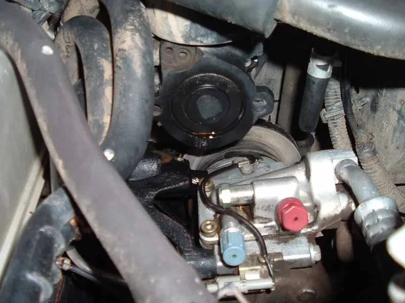

Problem:
Power steering pump has been leaking some fluid around the rear seal area. It would puddle up and deposit a turtle head on top of the A/C compressor.
The front seal never showed signs of leaking.
The only problem was I had to add fluid. The pump never gave me a signal that it needed immediate attention. So chalk one up for a good design.
Below are some pics of the rear of the pump and the effect of the leaking seal.

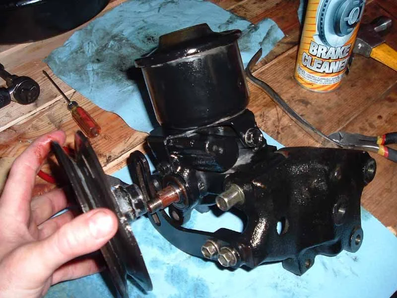

PSP removal
The 3FE PSP is some what cumbersome to remove. One can go about it two ways.
1.
a) Take the fan and shroud out of the way in order to gain access to the pump.
b) Remove the PSP pulley nut with a 17mm and take the pulley off. In most cases, the pulley might be rusted on to the PSP shaft. It's best if you use some PB blaster and let it sit for 20 to 30 minutes. (You'll see what I F*&K up later.)
c) Take the fulcrum'ing bolt out with a 14mm wrench on the right side of the pump and the tightening bolt out on the left side of the pump.
d) Remove the pump.
What you have done with this option is the remove only the pump assembly from the bracket.
2.
a) Loosen the fulcruming and tighting bolts on the pump.
b) Loosen the A/C compressor and move it out of the way.
c) Take out the 4 14mm bolts that hold the PSP bracket to the head.
d) Take the PSP and bracket out of the rig.
What you have done with this option is to take the PSP and bracket out and take the pulley off the pump while it's out of the rig.
The fulcruming bolt that the pump uses to hold itself to the bracket is long and can't be removed while the pulley is on the pump. You have to take the pulley off to remove the bolt to remove the pump.
I opted for two.

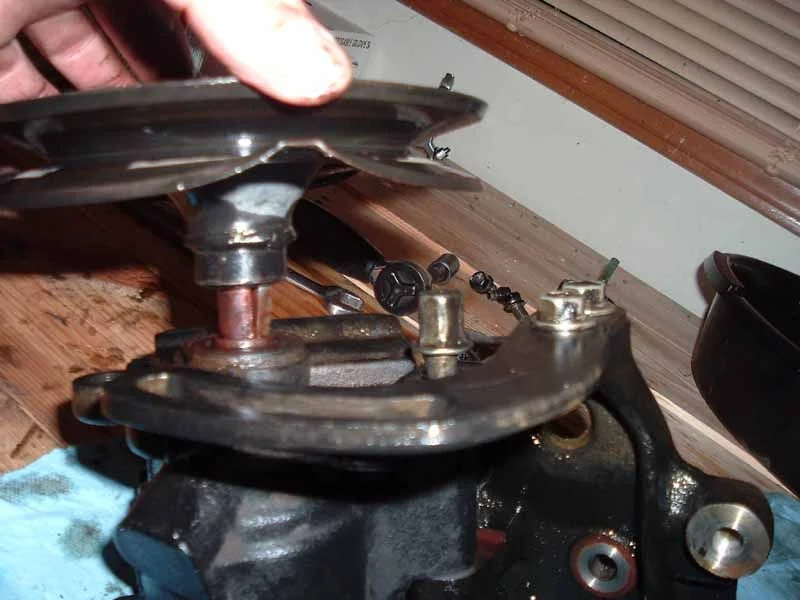

Gear Pulley
If ya can't get the pulley off after PB blaster, use a 2 finger or 3 finger gear puller to give it some assistance.
I use PB Blaster after I started to pull the pulley and notice I was distorting the 'V'. (too much Sam Adams)
Also, notice that the bolt does not clean the pulley. This is why the pulley has to come off first before you take out the pump.

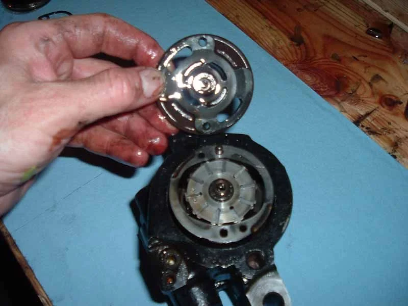

After the pump is out, go to the back of the pump and start the guts removal.

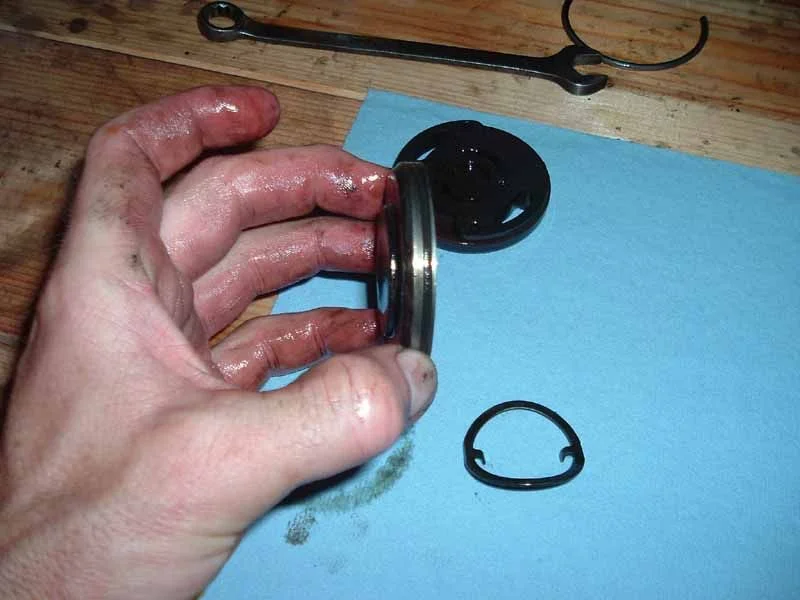

1. Use a small tipped screw driver and pry the metal snap ring out of the groove. Note: The snap ring has a chamfered end on one side, so a small tipped screwdriver work great.
2. Carefully remove the internals of the pump.
3. You may need to lightly tape on the rod end of the pump to loosen it up.
Be extremely careful at this point, for it you lightly tape too hard, you could push the vain unit out of the housing and spill the vains all over the place. This would be bad.

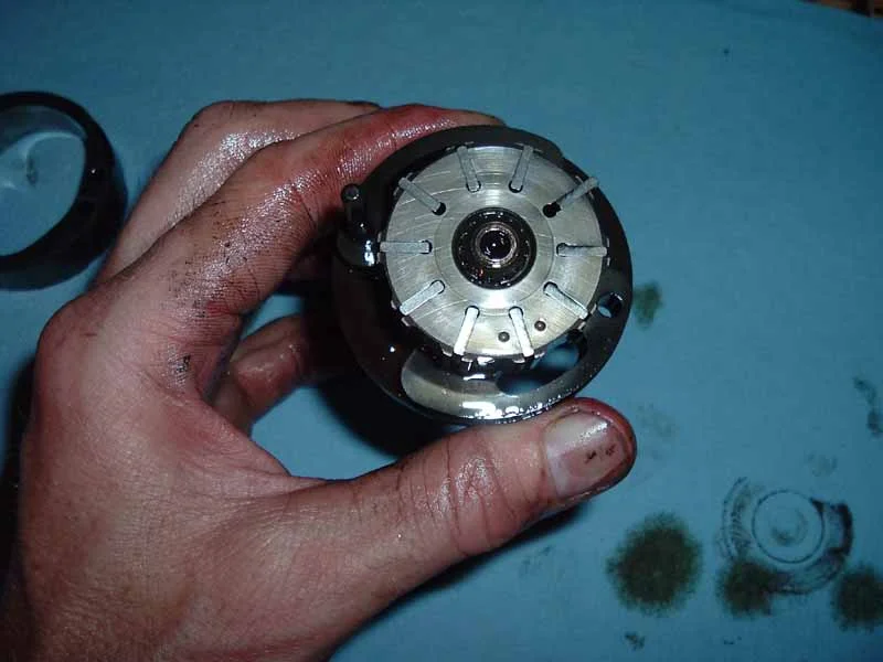

Pic 1:
This is the pump's primary function. The vains come out of the housing by centrifical force and compress the fluid to give preassure.

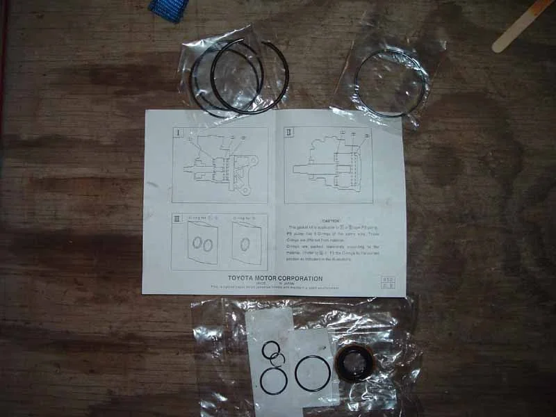

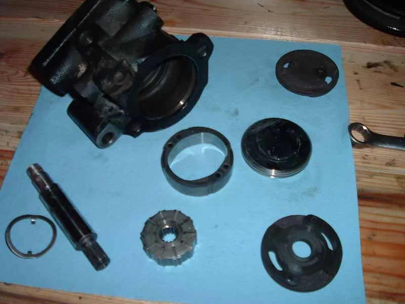

Pic 2:
The three seals to the left are actaully two 0-rings and one snap ring. The o-ring on the right is different material than the o-rings of the left, so dont' mix them up. The rebuild kit has instructions for ya.
Three o-rings, one snap ring and one front seal are on the bottom.

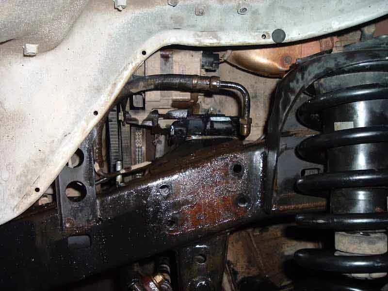

Gear box out
Well, I finally got the gear box out on Sunday night. Write up and pics to come soon.

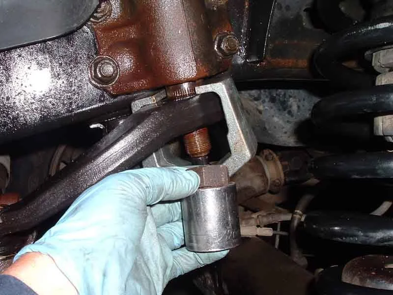

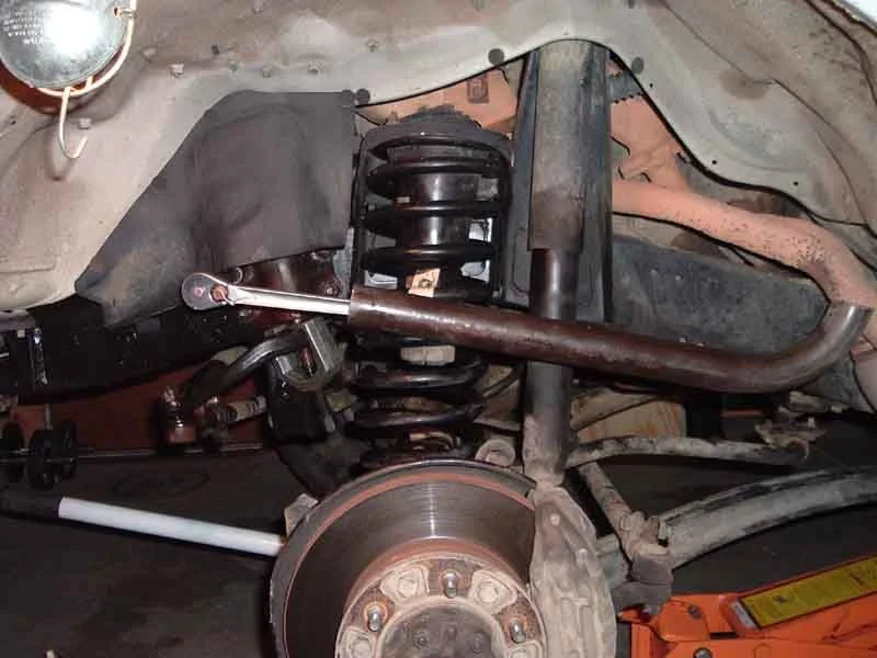

Pitman arm
Let me just go on the record to say that getting a pitman arm off the steering gear box is one nutbusting task.
Here's how I got the box out:
1. Took the tie rod off first. Wanted to get the pitman arm off first but the gear puller that I has would not reach in between the frame and the gear shaft as the shaft was tight against the frame. Not room to get a good bit around the pitman arm.
2. Took the 2 u-joint bolts out that connects the gearbox and the steering wheel shaft coming from the cab.
3. Took the two fuild lines off the box. Note: the old low preassure line was cracked. I'm going to replace the hose with some 3/8" stock from a parts store.
4. Took the 4 bolts that hold the box to the body off with a 17 mm socket on one end and a 17mm box combo on the other end. Needed some extra leverage with these 4 bolts.
