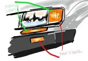

Ok, so it has always bothered me that the only turn signals for the front were on the valence, completely invisible from the side. I'd heard about using some sort of Tundra socket to make the corner marker lights into turn signals, but that sounded like a lot of work and rewiring of things, which didn't sound very appealing.
I started to wonder if I could just switch the sockets between the 2 housings. Well, low and behold, you can! Simply pull both lamps, remove the bulb socket from one and plug it into the other. Then reinstall. Voila! you now have a corner turn signal and a front valence marker light. I intend to tie my ARB lamps into the turn signal circuit, which will give me a signal light in the front again, but for the meantime, I think the corner lamps provide adequate signaling capacity.

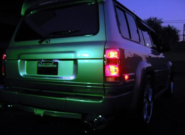

Just some suggestion don't just do the front but also add more light on the tailight.Go to Pepboys, Strauss or any auto store near you get pair of 1157 dual socket and replace those factory rear turn signal (1156) onto 1157 dual.Or you can make it much brighter with LED bulbs like mine on the pic.Just my .02 :rolleyes:
P.S: Ignore the bling-bling parts and for your own safety always disconnect the (-) battery terminal when do the electric in your rig.

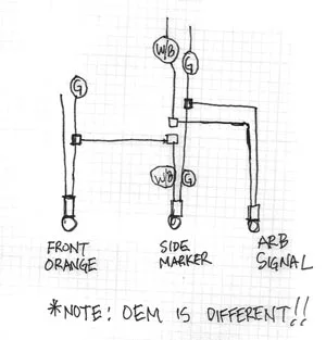

I think it was LR RESQ that did this a long time ago and I thought it was cool- I did my own version including the ARB signal in the mix.

I think this is how I have the park and signal lights on my supra setup. Curious though, with the park-lights on, do the signal lights flash opposite of each other or in unison? Also, I assume the one wire that isn't labeled (far left) is supposed to be W/B ?
With the running lights on, they flash opposite. If no lights are on, they flash in unison. The corner being lit is a nice fill light on dark roads
I drew that when I first did it so I wouldn't forget but of course... I forget! Well I probably didn't label it b/c it's a stock wire that I did not touch.
Also, I think OEM is reverse of what I labeled in the diagram. The diagram represents after I swapped bulbs, then added the ARB signal tapped into it.
