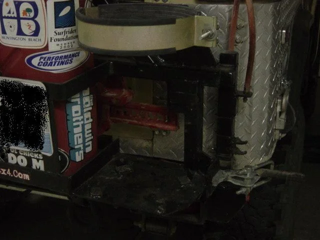

I have a 20 pnd tank mounted to my rear rack, next to my jerry can and spare. I bought a regulator that I got from williamsballoon.com, cheap. Never had a problem with it. Unless you need the "super" fill valves that some vendors sell then just get a standard one with a quick release. I figured I could wait the additional 30 seconds to have my tire fill up. The tank also powers an air block in the engine compartment which I run my arb's off of from pneumatic switches. No electrical or solenoids to go bad, all mechanical and air driven.
On a side note, I have about 50 of these switches I need to get rid of. I bought them with a good friend when at one time we were going to be putting a company and kits together. Never materialized. That being said, if anyone wants a pair of switches, let me know.
I will be doing the ROTW later this week and will include more info on the switches setup, cost, etc.
nother.....
