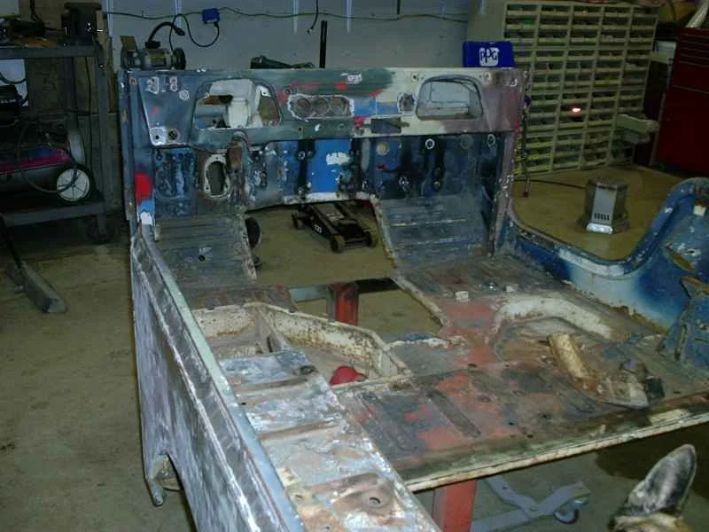

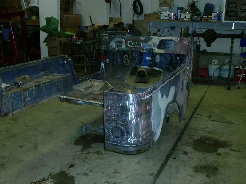

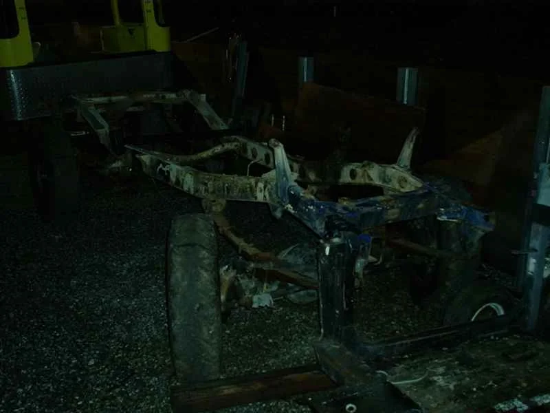

Everything is dissasembled now, the (temporary) sprung over frame has been pushed outside and has had a bath, It's amazing how good the 46 year old cream colored paint has held up. About 10 lbs. of mud and rocks are now removed from inside the frame channels. I'm doing the metal fabwork on the tub before it gets media blasted. 165 holes needed to be welded up or patched. So far about 100 are done. The large parts to fix are the 3 gauge holes in the dash, the radio cutout in the dash, the 5" dia. holes in the rear from resessed tail and stop lights, and the normal cruiser rust in the back channel. I had a local sheet metal shop brake me a new c-channel to replace the bad one, $4.67, Must be some profit for these aftermarket sheet metal parts. I hope to have the tub all welded this weekend. John Pardi

I'm doing the repairs and metal repairs first because luckally rust is not that bad, just the rear channel and bottom corners, mabye the 6 paint jobs this one had helped preserve it. when it comes back from the blasting i'll be ready to acid etch prime, underneath the tub, firewall and any areas that do not need filler. this way they won't flash rust while sanding, sanding and sanding. John #3

Okay guys and gals, give me a week and I'll be a photo journalist, but till then I have work to do. Jim I guess this is a rebuild/restore/renew get it back on the road job. most everything from the body up will be 99% stock 1960 FJ25 softop. I using a 2f enginge 78 4 speed tranny and transfer case, 1962/40 rear axle housing with 69/40 brakes and 1979/40 3.70 third member. Front axle is the stock 1960 with ball claw axles, 69 brakes and 79/40 3.70 third member, with drive flanges so I can have the stock non cut out hubcaps. Cut the body more than I thought I would today, Welded 46 holes up on the firewall, then started cutting the back channel off and noticed how badly dented the floor panel was so I cut it out. I grabbed a tub from a donor 76/softop 40 in the yard and cut the rear bed area out to put in the 25. I can use the piece I had made up to cap the rear and cover the 76 rabbit for the ambulance doors. "Film at 11", Thanks, John

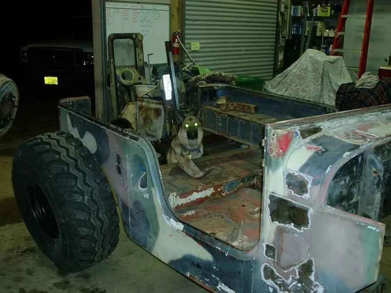

I conducted a suprise inspection of the Pardi garage last night, found him marking the wheel wells for slightly larger tires "while the sawsall is out"...Sadie the Merciless rides in expansive cargo area
Lots of extra holes are filled....rust repairs underway...things are coming right along! John showed me a possible factory heater switch, I shoulda got a pic of that...impressive parts piles!
