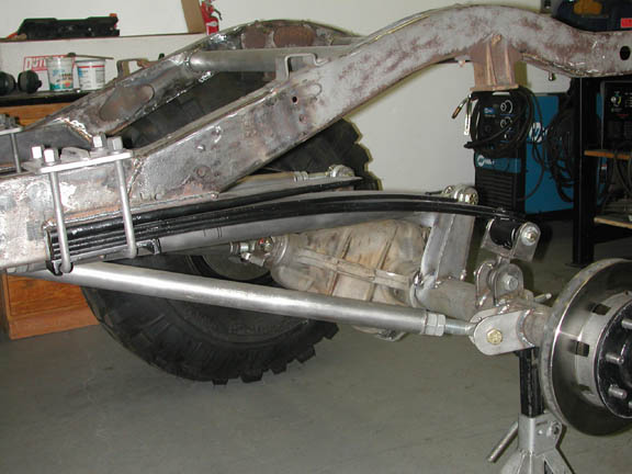

I Was Wondering What Type Of Spring Pack Is Used For Elliptical? I Have A Coil Setup Right Now. Its Completed Just Not Showen Completed In The Attachment. So Anyone If You Could, Give Me Some Tips, How To, Or Anthing That Can Help Me.

The first attached picture at the beginning of this thread shows the coils that Full_M3tal is considering replacing. I am confident that any well-designed quarter elliptical setup will flex far better than those particular coils, and given the same suspension (including shocks) produce less wheel hop. A quarter elliptical spring, used in a reasonable 4-link suspension behaves very differently than a normal (i.e., half elliptical) leaf spring system, so it is not entirely appropriate to lump them together in the general term "leaf spring system".
Full_M3tal: mine are used (salvage yard) springs from the rear of an F350 SuperDuty. IIRC, I paid $40 for them. Some F250 SuperDuty trucks also use them. The desirable packs can be identified by the presence of the overload leaf on the bottom of the OEM pack.
