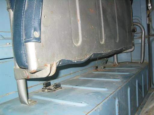

Here you go, see if these help.

Ok... Everybody was probally shaking their heads thinking that I was on crack because it's so simple. But here's my "hole" deal. I have 2 holes for each leg. The jump seat legs fit between each of the two holes which leads me to believe that there was either a bracket that the seats sat on and then bolted to the well OR- there is a different style seat.

I'm not sure these will help you, and apology for the blurry view, but this is how the long jumpseat and the factory soft top mount in my unrestored '77:
ed: something else: there are a few unused threaded holes along the upper rail (whatever it's called where top meets tub). All I can figure is that they are generic installed to allow each cruiser to be configured in different ways. So I don't worry about 'extra' holes.
THanks all for the pics and information. Seems that '68 and prior (at least in the US) there are diff's in the mounting configuration for seats. I have a set of seats for >'69 to short style seats and although they would easily work and nobody would know the differance - except me!
