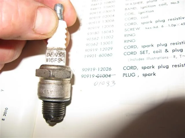

Kurt, this is the plug from my 9/64 F135 which is the correct Toyota part. Unfortunately, I don't have the box it came in to be sure of the Toyota PN, but here is what is in my 67 parts book, which should correspond. The original number is 90919-01004, apparently upgraded to 90919-01083. (Thread is 1/2", BTW)
I got the plugs from SOR, though, and there's a chance the number is further upgraded. Your dealer, I expect, should be able to get it from the original number, though.
