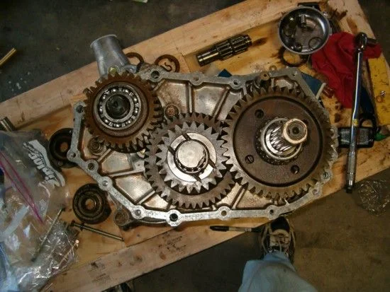

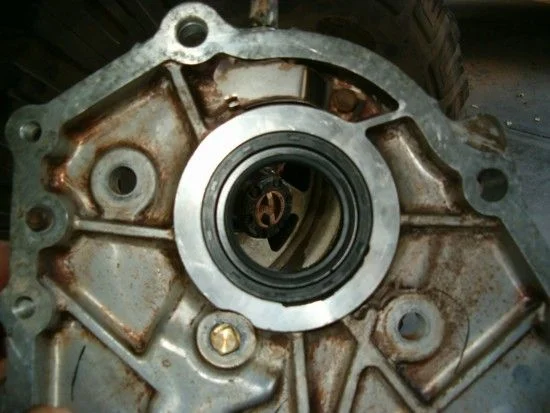

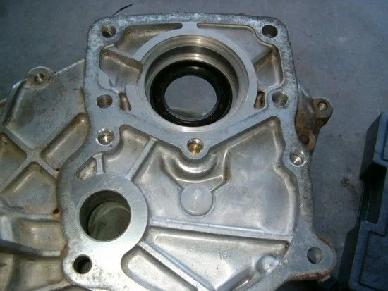

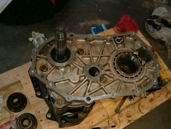

It's non-sense. I've just rebuilt a split case and mounted it to a new H55f. You do have to plug one of the bolt holes in the transfercase, and snap in a plastic oiler cup but that's it. I'm planning a full write up, but I'm waiting on a shim set from Cruiserdan (thanks bro) to get the output bearing preload right. Now that I've done one of these, a second one would be easy. THere's a pic of the plug in the extra bolt hole, and some pics during the rebuild. The first pic is the front of the case with the new oil seal and plug, the second is the front of the case bolted to the H55f, and the last pic is of the gears installed, just before the installation of the rear cover. The gears in this case are seriously stout-Toyota built this box to last.
I forgot to mention that I built a rolling stand to hold the H55 vertically while I built the case on top of it. It's crude but it works great. The tranny is bolted down to the sled making the whole assembly very secure easy to work on. If you look carefully at the first picture, you can see my FJ40's front hub.

There is a good view of the oiler cup in this picture. This is the transmission side of the front of the transfer case. The relief area is already cast into the case, you just need to snap in the cup. Just above it you can see the brass plug in the bolt hole I tapped. See also the pics in this thread that I posted a few days ago:

Yes, the hole has to be tapped, it has no threads. Normally the bolt passes through this and bolts into the transmission. I used a 1/4 pipe thread tap which fits almost perfectly. Carefully tap the threads and bolt in the plug with locktite. On the other thread I had some pictures of the tap in the hole, the threads (which came out really clean), and then the plug in the hole.
