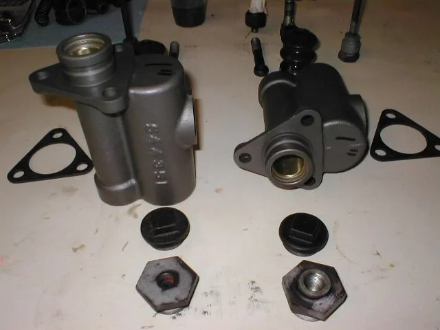

I have not taken any of these apart yet, I'm hoping they use standard cups as I have seen similar cylinders on old Chevs...Anybody use Apple Hydraulics for the brass sleeve job? Any NAPA part numbers for a rebuild kit? :rolleyes:
Any decent hydraulics place can get the cups. the wheel cylinders are 1", and I imagine the masters are, too. I got a couple of rebuild kits from SOR a while back, but I ended up going with later brakes. I'd rather not rely on single circuit brakes.
You can get the rebuild kits from SOR for a reasonable price, the cylinder and kit is the same for both the clutch and brake, the only difference is the check valve in the brake cylinder. They're standard 1" bores, I usually just get the 1" cups and boots from a local parts house for the wheel cylinders. This is what they will look like when they come back from Apple: :D
