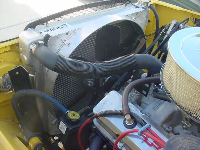

I'm running one with a SBC. Very happy with the cooling ability! With the stock rad I couldn't get the temp under 190 with a 160 thermostat. Now, it doesn't go above the thermostat temp (Ihad to replace the 160 with a 180 to get it to warm up).
The fit is OK cept for the drain. It's nowhere near the factory cutout. I have a black magic electric fan that works well, but I may look for a taurus or clutch fan.
Rice,
What model Griffin radiator is that you are using? How did you mount it? Look kewl.

Model number is 55222-X. Dimensions are 26 in. Wide, 19 in. High, 3.0 in. Thick
To mount it just did away with the OEM radiator frame and place square tubing between the bottom of the radiator and the orginal frame mounting points (and added some rubber bushings).

dgangle, the shroud is aluminum I got from Home Depot and pop rivited together.
