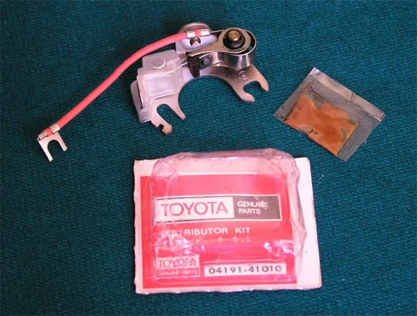

I've been saving these for 25 years. Where do I install them on my '97 LC? :)
Uhmmm.... next to the carbeurator??
Wow,
04191-41010 pointset for 75-77 vehicles with ignitors. My '77 Celica used those.....
You could install them on my '76! Or you could send those relics to me to use for spares.
