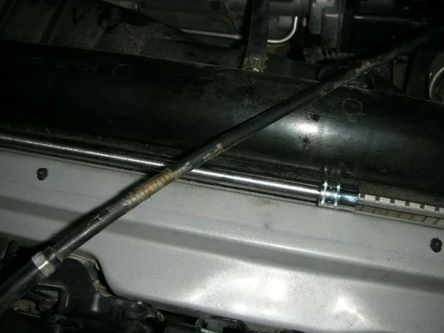

I re-realized that my throttle cable was starting to deteriorate on the outside the same as I've seen on some other rigs here. Honestly, I don't know if it would ever hurt anything but I fixed it pretty simply. First I straightened it out to make sure it was moving freely and it was so I used some heavy duty heatshrink (the kind with glue) and protected the sections from the fusebox area to the throttle body. I also straightened it out where the last mechanic to work on it tangled it around the spark plug wires.

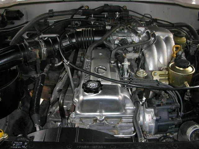

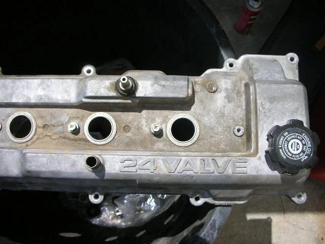

My valve cover was looking pretty crappy, so I decided to spruce it up a little too. I just cleaned it with a blue Scotch-Brite on a die grinder then a realy soft wire wheel to get into the nooks and crannies and get rid of the Scotch-Brite marks.
