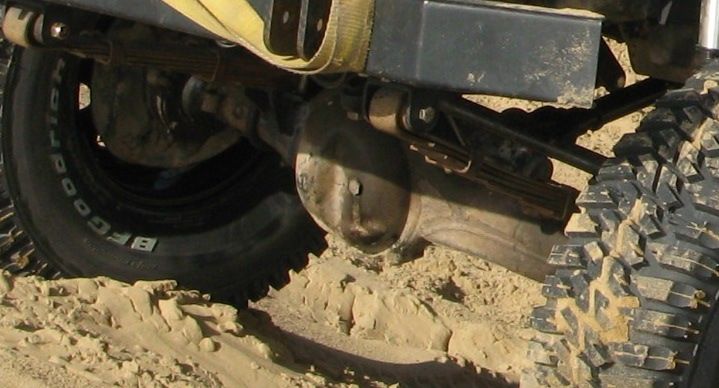

An fj62 front axle is trussed underneath in a fashion similar to an 80-series rear axle. Also the backing plates have ducted vents that pull air into the brakes.
