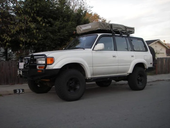

Well, here is the deal.
If you look at the first picture on this thread...
https://forum.ih8mud.com/showthread.php?t=118830
You will understand why I needed to make a change.
The lift you see in that pic is OME 850 front and 863 rear.
They look great without a load, but with a full Long Ranger, CTT, full Drawer System, Engel 45 (with lots of beer), firewood, etc...you see what happens.
The following pics show the truck with a similar load, after I have put 850J's on the front and OME 4" COMP springs in the rear.
I am very happy with the way it turned out.
Give me some feedback, if you would.
Can't wait to test it out in Death Valley this coming weekend! :bounce:
Looks good, any reason why you didn't go with the 4" comp springs in the front for future proofing?
Thank you.
Because I liked the ride in the front. Smooth sailing through Mexico so I wanted to maintain the ride but get it just a bit higher. With the bumper, winch and dual bats, it sits just right (for me).

I think without the tank and tent, you should be okay. You have to realize, with the tank alone, that was 352 extra pounds with a full load and the tent is 110. That just about exceeds the 863's right there. You would probably want the 864's with your load.

It looks really nice and makes sense when loaded down, but how does it ride when empty?

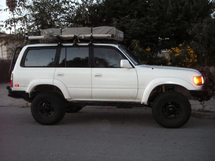

What's the tube on the rack next to the tent? Awning of some sort?
The truck will never really be empty, that is one reason I went this route. The drawers, always loaded, spare parts and camping gear.
Tank, I try to keep as full as possible when traveling. If I take the tent down, I will be puting a cargo rack up there. The fridge and bumper with spare will always be there.
This is not my daily driver so it will usually have all of the goods when I drive it.
I have done some freeway driving and around town since I put it on and it feels pretty good with a standard amount of weight in the back.
The tube-like thing is a fishing rod holder, I use if for rods and my Hawaiian sling, along with some awning poles.
