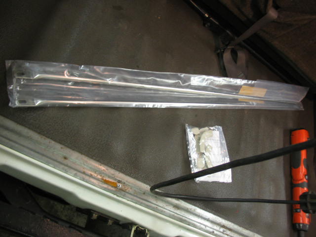

this top is very different from the aftermarket tops. the design is second to none. they thought of everything. the top comes with new window hold down bars, new interior trim for the doors. it is VERY complete.

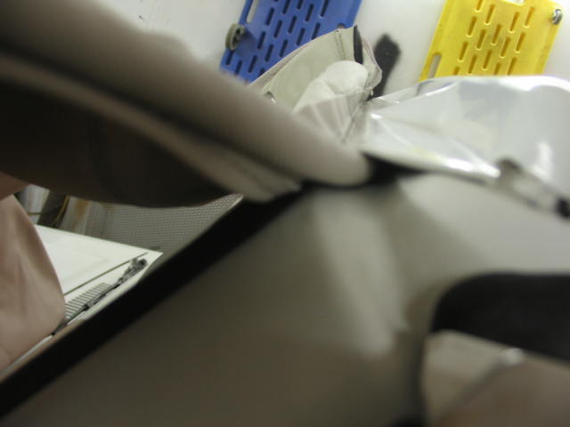

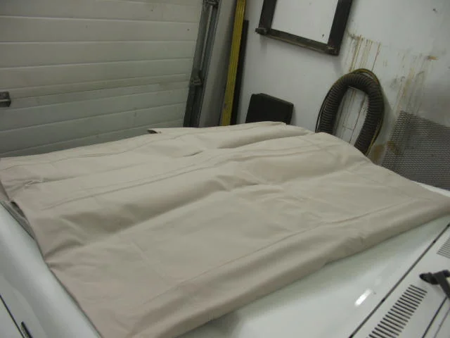

the way the top is folded at the factory makes sure the windows don't get crinkled or cracked dduring shipment.

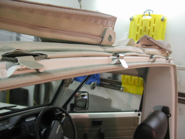

you start at the front of the vehicle.

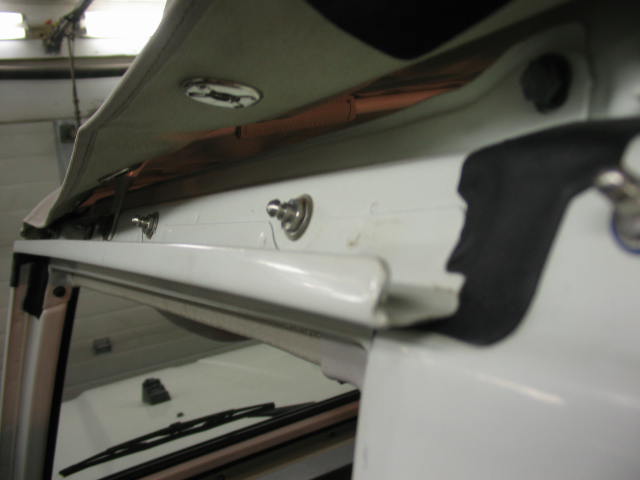

insert the "rope" into the channel above the windsheild frame making sure the outer trim fabric does not go under the grove and making sure the rope is fed straight in otherwise it binds. if it is not moving freely then stop and check out the progress, you will find something is not where it should be.
also be careful of scratching the paint of the truck as you drag the top from side to side.

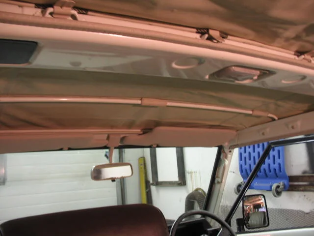

then pull the top towards the back and attach the velcro anti flap wraps...

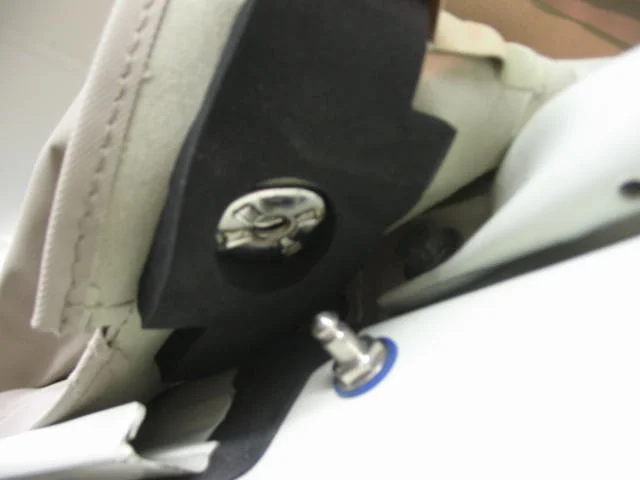

then there is the rope with the clips to hold the top to the roll bar. insert these and then snap the side clips.
notice the sealing foam around the back snaps...

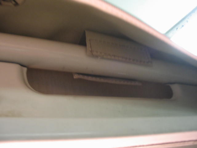

insert the rear most rope into the recievers inside the rear door access once again making sure it slides easily.
this flap comes all the way around the rear pillar and attaches to the inside for a very snug fit.
now attach the velcro anti flap wraps around the middle bar.

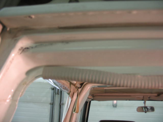

this is looking at the rear door opening from the inside, notice the 3 flas that are hanging loose to cover up the metal assembly. these will be installed in a few minutes but must be accessable so make sure they are not stuffed in the wrong area.
the area where the top goes over the rear door has 3 attachment points. the anti flap velcro wraps, the snaps and the inside flap. this makes for a very secure, air tight assembly.

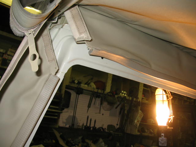

don't forget the small flaps in the upper corners of the door opening. i missed taking the pic but this is where the plastic curved corner covers snap in as decrative trim...
the top is looking tighter.

you need to slide the new retaining bars into the slot along the bottom of the window. make sure you insert these into the leather tabs at the ends.
