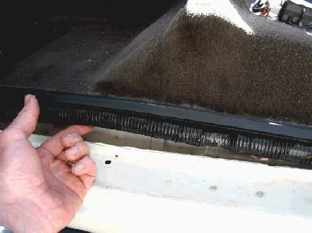

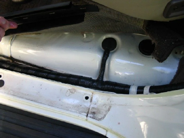

The fist picture shows the DSFD sill. If you look in the middle of the harness you see where the tube is interruped and only has the eletrical tape, this is where the first section branches off under the seat.
Second picture sucks, I know. This end of the harness has 4 connectors but you only connect 3. D is not used. Also the tube for the washer fluid for the rear runs through here. Make sure you plug this otherwise it will leak washer fluid into the cabin.

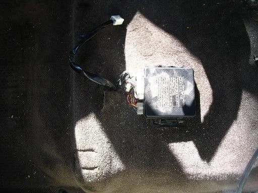

The third pix shows the alarm. You can't see it that well but there is a decent size opening that lets you get under the carpet both ways.

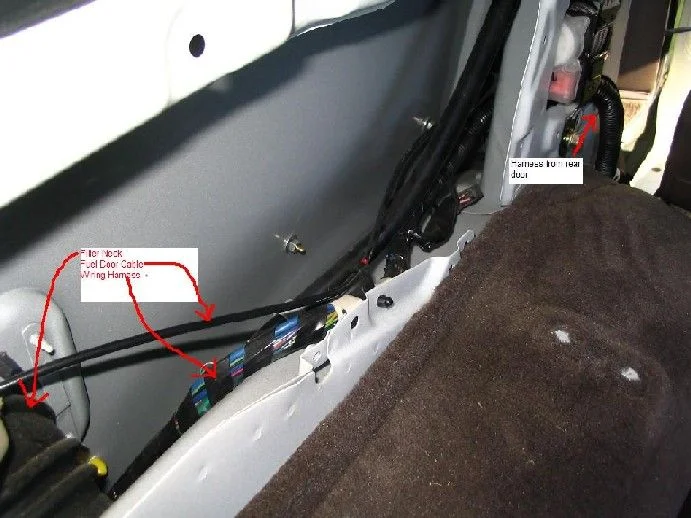

Ok here is the rear section. To the rear of the filler neck the harness exits the chassis and joins the rear sill harness. I installed that one today and will add more on the tomorrow or Thursday.

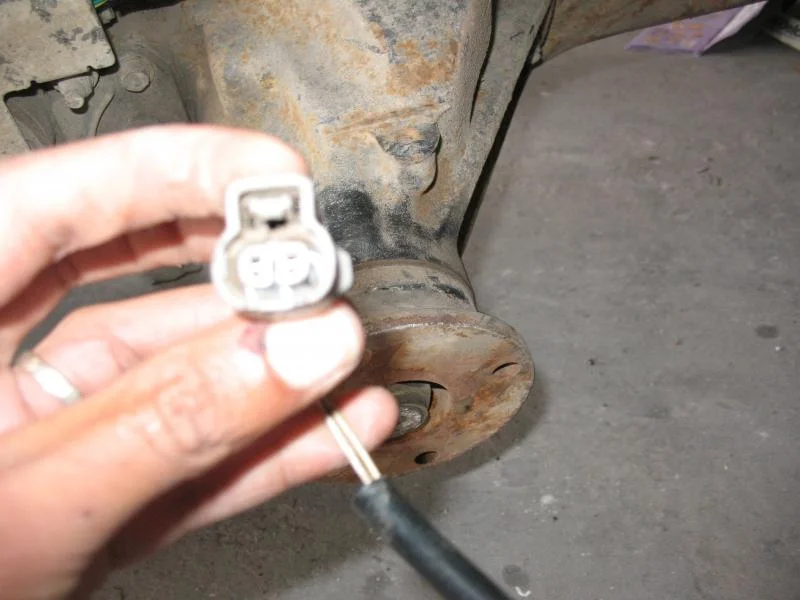

pics of connectors
Here' a pic of one of the connectors that the junk yard cut the wires, that plug into the elocker. I couldn't get the other pic to upload.
I'm assuming I need to run these to one of the connectors underneath the jack mount, but what type of connector do I need at the other end of these wires, so that it can plug in to the LX450 harness?
