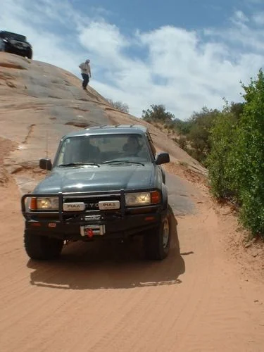

My truck came stock other than an ARB front bumper and PIAA combo drivelight/fogs and I was slow to build it up. Kept it on a stock lift and 265 BFG AT ties for a couple of years and used it mainly for camping. it wasn’t until I went out with Riley on his medium lift/305 MT/Rs that I could see the point of a lift and tires and the point for me was mainly that Riley seemed to be able to navigate all those deactivated culverts ditches we get on BC logging roads without burying the nose and scraping the behind.

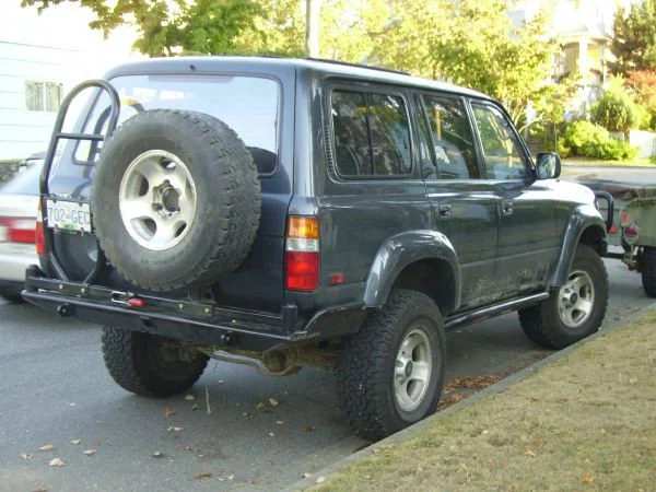

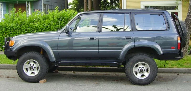

So I juiced it up to an OME medium lift for about a year and went to 285 Ats and that was perfectly good except then I wanted armour and didn’t want to sacrifice my lift so I went to J’s all around which more than compensated for a winch, sliders and rear bumper as it turned out :rolleyes: . last summer I bought an older warn m10000 winch used on a municipal truck and installed it this spring. I got to do this after my wife got on my case about not wanting to get stuck when we went camping solo in the bushes (happy to oblige there honey :D ). Added Hanna sliders and a 4x4 labs rear bumper this spring at Cruise Moab (and in the process got Luke a few orders I think since he kinfly installed it in the campsite). Yanked the rust trap stock roofrack and added a couple of sets of Yakima crossbars which work like a darn.

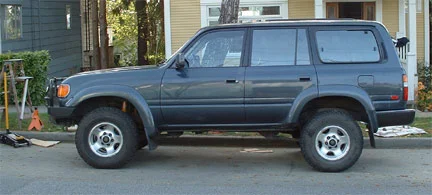

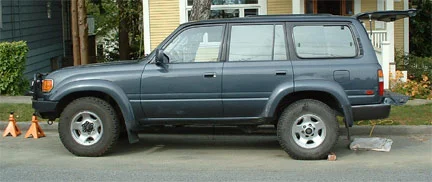

Anyway, there’s the scoop. Here are a few photos. first the evolution of the truck from stock 265s to mediums with 285s to Js.

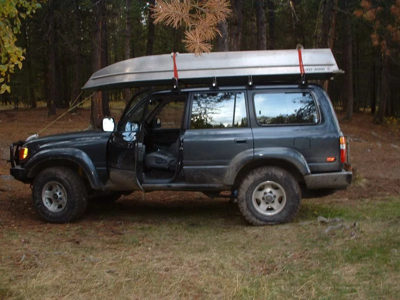

and here's a shot of Luke Porter and his buddies working their magic, a shot of my 4 bar yakima system keeping Riley's jon boat just as secure as you like and my other 80 series, purchased in France, which my kids recently pointed out now has the same lift as my truck.

Good write up Simon, hey we need a pic of that rear bumper. Looks pretty interesting. Or better yet, pop out for a beer sometime.

I have always liked the looks and lines of the 4x4 labs rear bumper. I'm sure they are all very nice and top notch but a few of the others just look TOO overkill. I know with hardcore rock crawling and the weight of these trucks, overkill is not a good term. But i'm sure that Luke's rear bumper will easily hold it's own in rigidity.
