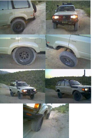

Please share pictures if you get a chance...very interested in this tire size
are those BFG Mudz? What size wheel? Just curious. I guess there are not a lot of people running the 255s in the brands I mentioned above.
Thanks for the pics
Smit
I have a set of BFG MT's in 255/85 on a set of black steel tundra wheels for Mexico. 7" wheels are just about right for the 255's. Much wider and you really start to expose the rims to damage. Unfortunately I do not have them on right now but may have some pics at home.
Thanks for the pics
Smit
Yes, BFG muds. 8" wheel. Not sure where you are, but I think Big O's house brand XT also comes in the 255/85/16 size. Redesigned tread recently, and looks like a good cross between MT/AT. The brands you listed are not large sellers, so the likelihood of someone already having them on an 80 is slim. The size is rare enough, and the BFG's are some of the most widely available ones, with a decent price.

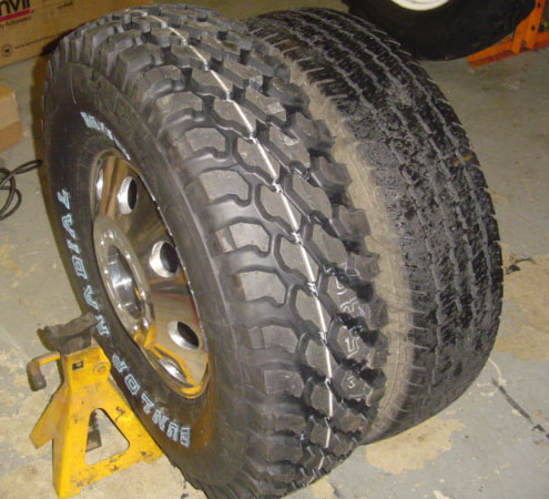

I run the same tire on my 94 80 and my 92 4runner on fzj80 al. wheels (16) and I LOVE these tires, they have a "D"load rating but the traction of this narrow tire is off the charts.
FWIW, I have these new ones mounted and next to my good year Wrangler MTRs (35-12.5-15 on 15x10 wheel) on my trail truck and hte 255 are actually about 1.25" taller than my 35s.
and the 8" wheel is as wide as you can possibley go (I have done rim edge damage quite often) so ELjefe is right on about the 8" inch max.

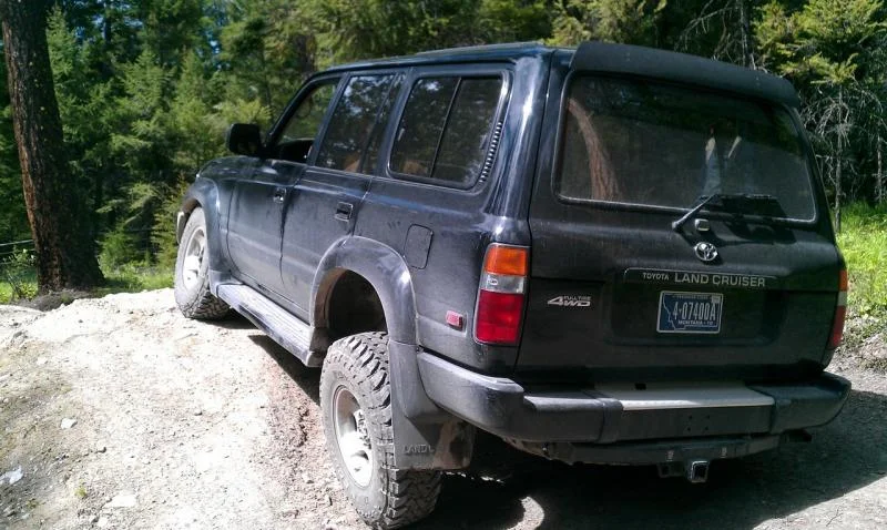

Toyo 255 85's on Ice
Here you go, pictures of Toyo MT's 255 85's on stock suspension and my father-in-law holding the truck up. :) Regear is not needed in my opinion, I just leave the power button on. It goes pretty well.
I like them, but they suck on ice, and they are pretty dangerous for the wife. She is a white knuckle driver on bad roads since she flipped our Accord going down our canyon road a few years back.
I am going to have to put either Duratracs or Winterforce with studs on this week. We've had some really icy days this winter. This morning, I went down the canyon and it was absolutely clear ice. The ABS was the only thing that would keep me straight for about 3 miles. I just held the brakes and steered while the ABS was pumping away. With the ABS working none stop I was sliding about 200 to 300 before the truck would sort of stop. I was afraid to come to a complete stop because I might slid sideways off the road.
With the center diff locked and the ABS off, if I just touched the brakes, the front tires would lock and the rear would start to come around.
Granted, this was extreme conditions, and no tire without studs would stop on this stuff. I have never ran the newer winter compounds, but I doubt they would work better then studs on clear ice.
I was having fun, but I was by myself and no cars were on the road. :hillbilly:
Great tires for summer, bad for Montana winters.
