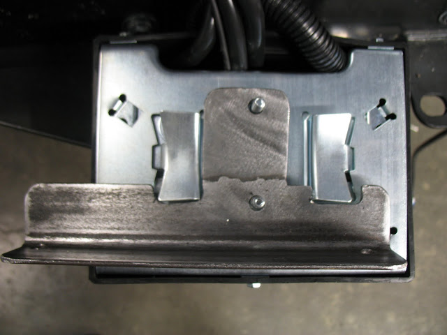

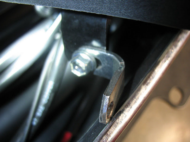

Friday, April 12, 2013: Installed winch into bumper in feet-forward position without clocking brake housing (left a voicemail for D'Animal asking if/how housing should be clocked). Had to buy 2 longer bolts for fairlead to winch mounting. Mounted solenoid box in standard location, but found it would not fit when reinstalling bumper. Fabricated temporary bracket to hold solenoid box in location near license plate. This was when D'Animal returned my call and made the above comment about doing things right the first time.
Picture of temporary bracket attached to Warn bracket.

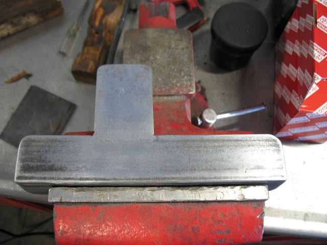

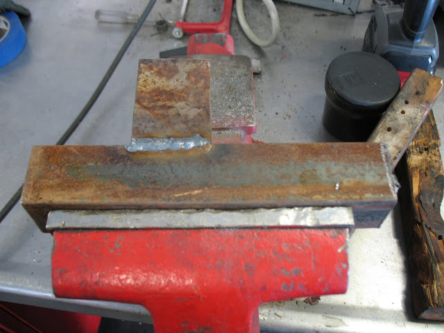

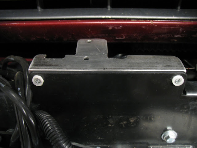

Friday, April 19, 2013: Received bracket which my cousin graciously welded together from scraps on hand.
https://lh6.googleusercontent.com/-qOtZ4EZ5JdM/UXObTAC2EKI/AAAAAAAAEt4/ATx437oYmZE/s640/IMG_5829.JPG

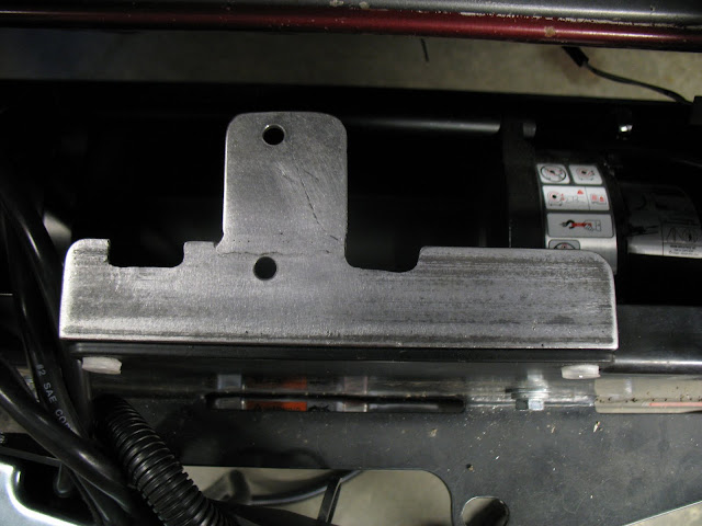

Saturday, April 20, 2013: Worked with grinder, sander, & drill to make a finished product.
Had to make some cutouts to fit the bottom of the solenoid box.

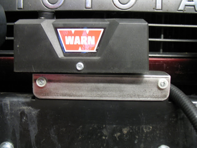

It looks real nice mounted to the back of the license plate tabs...

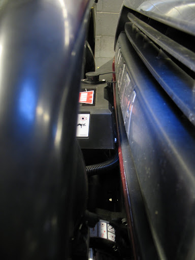

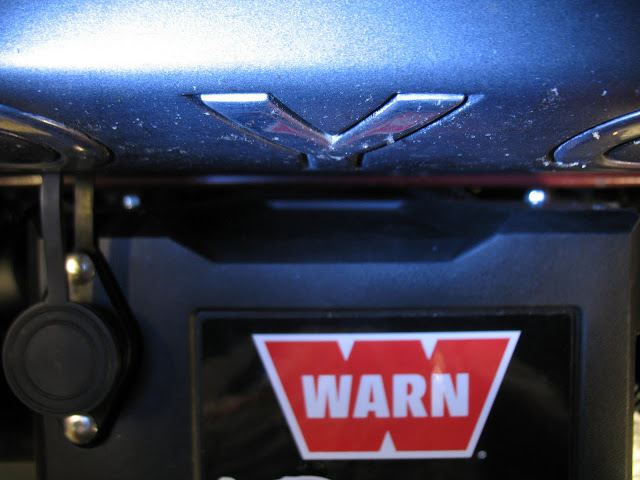

...but it located the box too close to the grille & valance. Rather than elongate the holes, I just mounted it to the front of the tabs. Now it fits just right.

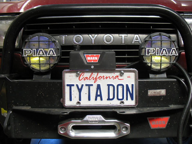

All installed, but oops
, it's not painted yet. I centered the box over the fairlead so there would be more space to access the brake control lever.
