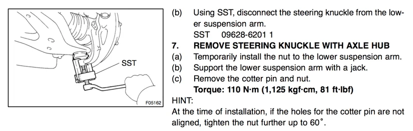

Like this,
Btw, on the manual, they do pull the UCA with the puller as well.
BUT I think that the whole knuckle assembly should drop down once you pull/slide the shock out.
Let me know what you think,
I don't think I had to disconnect shock, and I'm pretty sure you don't have to disconnect upper ball joint. I don't recall that I disconnected the steering arm either, but that may let you manipulate the knuckle out of the way. Remember, the torsen bars are forcing the LCAs down, so with the truck on jack stands, you'll have jack up the LCA in order to take pressure off that joint and swing the knuckle out of the way.
That being said, when I did mine, I took the whole knuckle off because I rebooted both the upper and lower ball joints and rebooted the drive shaft at the same time.
I undid the steering arm, but didn't have to do anything with the shock. I posted up a puller that O'Rielly's has (in the main lower ball joint instructions thread) that clears the dust shield so you don't have to use a pickle fork.
