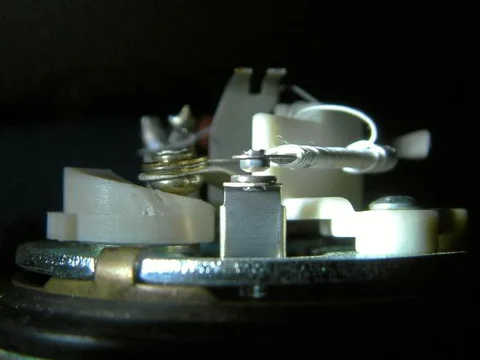

Once inside, you will notice how elegant the design is.
There is a rubber disk seal on the flange and it has probably kept the inside quite clean. Careful, don't lose it, you will need it when putting everything back together. The sensor itself includes a piston pushing a contact against a bimetallic strip around which a white coil of wire is wound, a toothed wedge-shaped wheel for adjustment, a resistor and a flexible contact strip contacting the central pin insulted from the can feeding the dash gauge.
If your sensor was giving abnormally low reading, you will notice, surprise surprise! A substantial gap between the contacts of the bimetallic strip and the pressure actuated bottom contact. No wonder it takes pressure before it will even get off the zero mark, and that high pressure reads so low!
Next to the contact on the other end of the bimetallic strip you will notice a ball pressing against a sloped wheel. You guessed it, that's how the contacts are adjusted. There is even a provision for using a splined adjusting tool, but using a screwdriver blade will do just fine.
Simply use the tip of the screwdriver on the teeth of the wheel to rotate it so that the bimetallic strop lowers down until the contacts touch. It's that easy!!!

OK... after driving the truck this afternoon this is what I noticed: you don't want the contacts to actually touch at rest. That may give you a slightly off-zero reading...
Secondly, I notice that the oil pressure is slightly above the first mark at idle and slightly below the second mark at 2000 RPM. Although it may be just fine, it would seem to me that the response band is fairly narrow (assuming correct oil pressure), confirming the theory that the main issue with these sensors is not mainly contact wear but loss of bimetal response after so many million bending cycles.
I will keep looking into it, of course, and I'll test my spare sensor also but it may well be that these sensors just loose sensitivity with time and that it may actually be more cost effective to replace the sensor with a new one.
