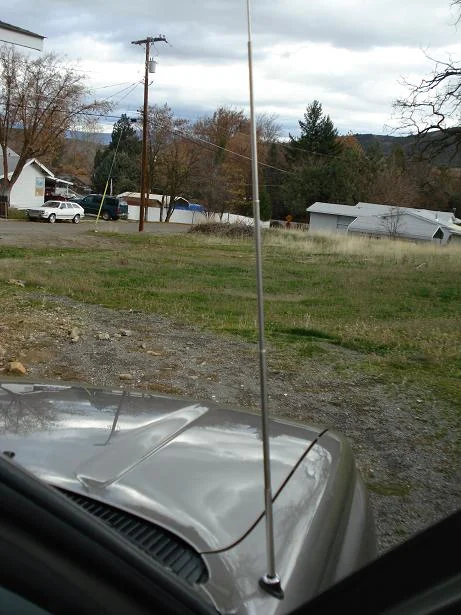

Well, it broke... just like the one in the 90 4Runner we used to have. The plastic geared push rod snaps near the end and the antenna goes up, but not all the way and the motor just runs untill you pull it up.

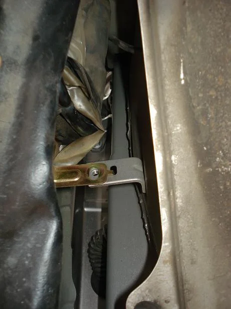

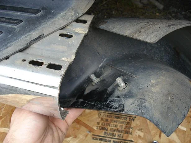

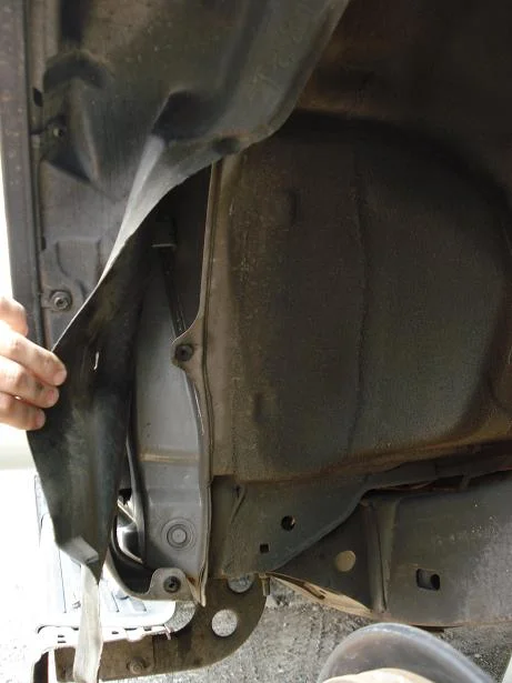

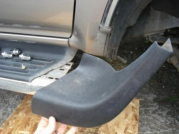

First step, is to remove the tire, so you have room to remove the front trim of the running board. There's 2 nuts from the bottom, and 2 screws from in the wheel well.

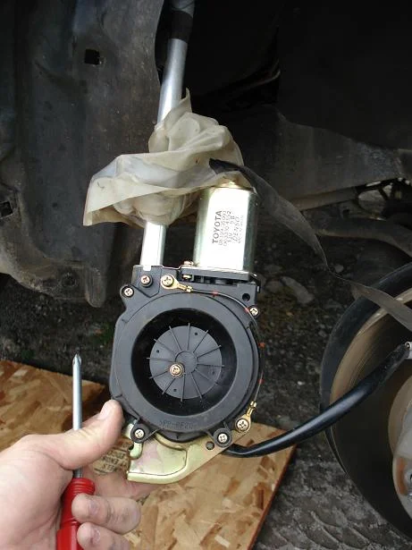

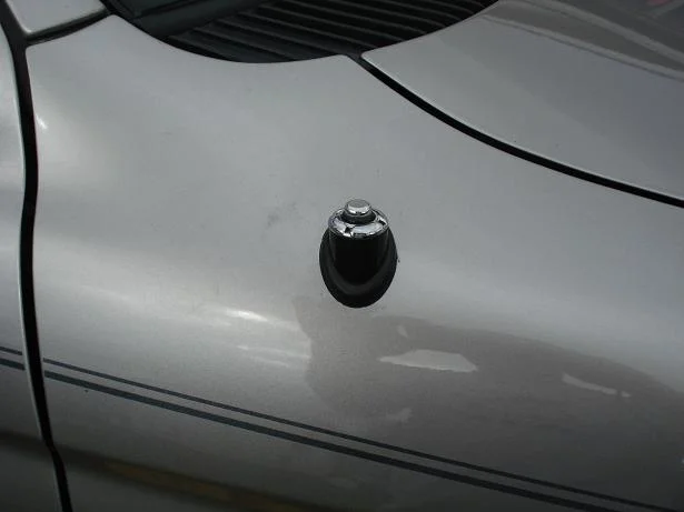

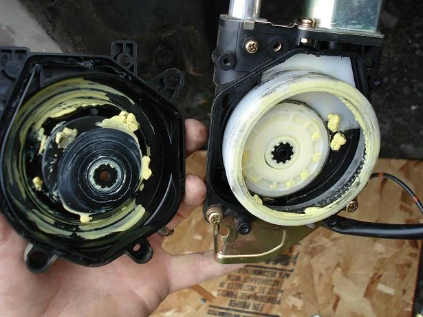

Next step: Remove the antenna. I used a flat blade screwdriver to unscrew the top crome trim ring (Always pull towards yourself so you don't slip and scratch the paint) and there's one 10 mm bolt holding the bottom end in place.

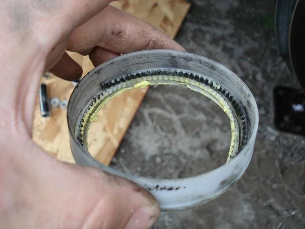

You need to remove the antenna assembly, because if it broke.... then it left parts inside, see broken rod in the plastic ring thing.
If you wanted to just replace it as PM, you could do the whole job just by removing the chrome ring on top, and pulling it out. And it would take 2 minutes instead of 30...
Once the chrome ring is off, you can remove the old "mast" by turning on the stereo and selecting a setting that will extend the antenna, as it does this, just pull it out.
Once you have the broken peice out of the assembly, installing the new mast is just a matter of turning off the stereo so the motor will start to retract the mast, and as it does this you push the end of the new push rod down the hole...
Make sure the teeth are pointed in the right direction. If the motor is back in the vehicle, then you want the teeth to point forward. If the motor is not installed yet, you want the teeth to point towards the motor on the assembly.
Then put the chrome ring back on, and tighten. Then install the 10mm bolt, and put the rest back together.
