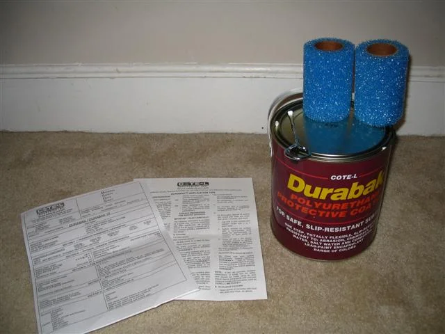

Well, the package came in the mail today that i have been waiting for. Cost was $90 and recieved the product within 5 days of ordering. Here's what i got: One gallon of black durabak, two foam rollers, container opener, MSDS sheet and directions.

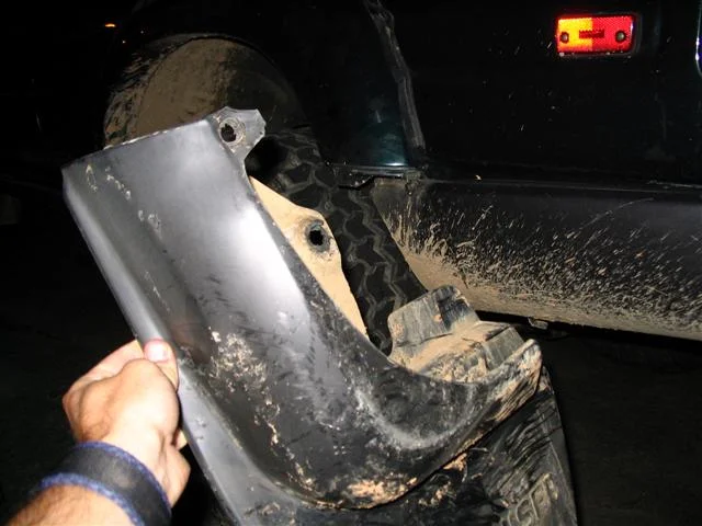

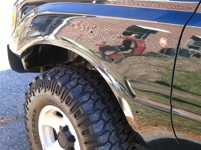

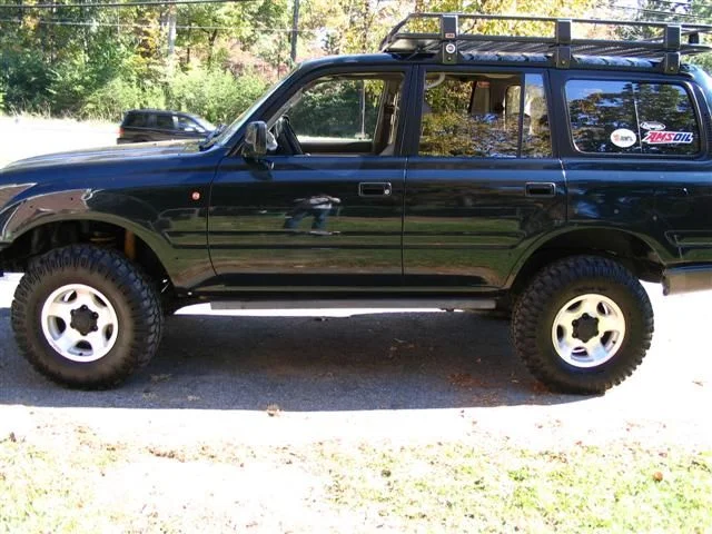

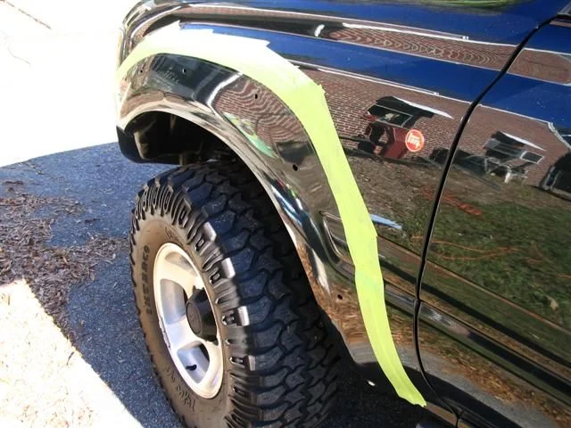

Here's a couple of shots of the rig before the treatment.

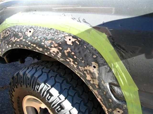

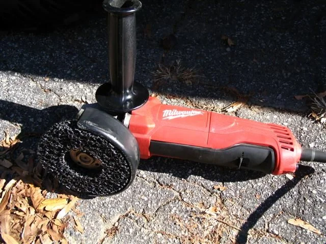

First thing i did was wash the truck completely. Then i taped off the lines i wanted making sure the tape was sticking to the fender well, then applied a second layer of tape. Next i took my 4.5 inch grinder and using the wheel pictured below, removed the paint especially around the holes and disturbed the paint everywhere else (this was extremly gut wrenching with the thought of no-turning-back!!). Then using xylene cleaner, cleaned the areas thoroughly.

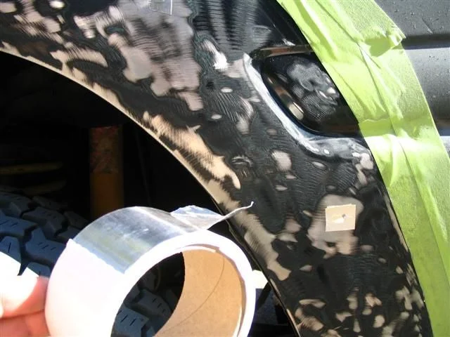

Another pic of the fender paint cancer :frown: :o .
Next using some aluminum tape i have, i cut some small squares and covered the holes with at least two layers of tape.

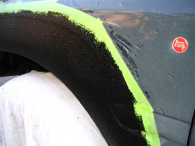

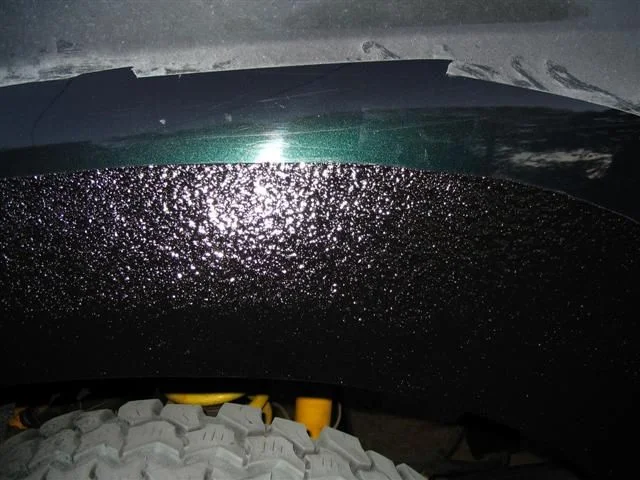

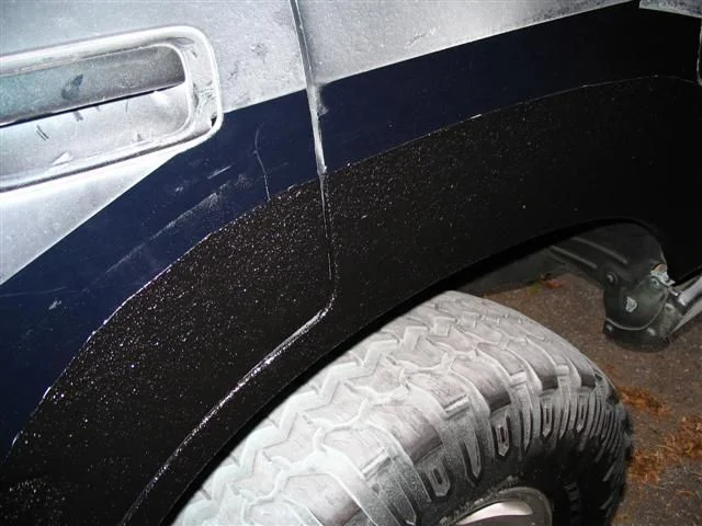

Last of the day. Then i stirred the product up, poured it into a roller paint pan, and rolled it on. First coat doesn't seem very thick, so i let it sit for an hour to dry, then rolled on a second coat. Here's a couple pics showing how the edges turned out. I will do the rocker panels and other side tomorrow.

Not sure you actually needed to sand that much paint off, though. I bet scuffing it up with a scuff pad (3M makes them for things just like this, similar to ScotchPads) would have been plenty sufficient for the Duraback to stick. Is there something I'm missing here?
