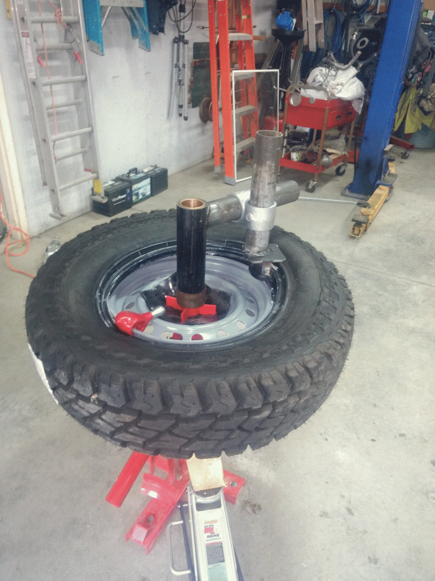

So I did the experiment. Harbor Freight all the way.
Did the well documented mod to add the piece on top with the plastic "duck tail" I think it's called to help with the job. (In this photo the bead breaker function had not yet been destroyed. That happened which removing Chinese tires from my other set of rims. As bought that part of the tool is worthless.)

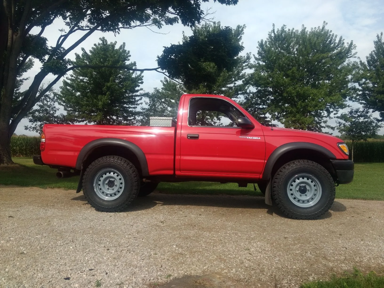

Mounted Cooper ST MAXX 235/85-16 onto Tundra steelies. Given the E rating and all that the mounting wasn't that bad. It was my attempt at static balancing with the HF balancer that was a total failure. No matter what I did I couldn't get the balance right. Each time I got a little better but it was getting ridiculous. Given these are big heavy tires on a little truck but still.
Finally gave in and took the truck to the shop to get the tires balanced. They had to use a stupid amount of weight both inside and out. So I don't think I had a chance. I've got an old Mk1 VW Pickup that needs 13" tires. Going to try that I'm sure it will go much better.
Is it worth it - not really. I like to have as broad a skill set as possible but this was a little silly especially the balancing. I can see it if all shops around you refuse to mount your tires - but then maybe you shouldn't be mounting them in the first place.
(In this pic the weights shown are my first attempt at balancing. Today they carry WAY more weights - like 3 or 4 times the weight.)
