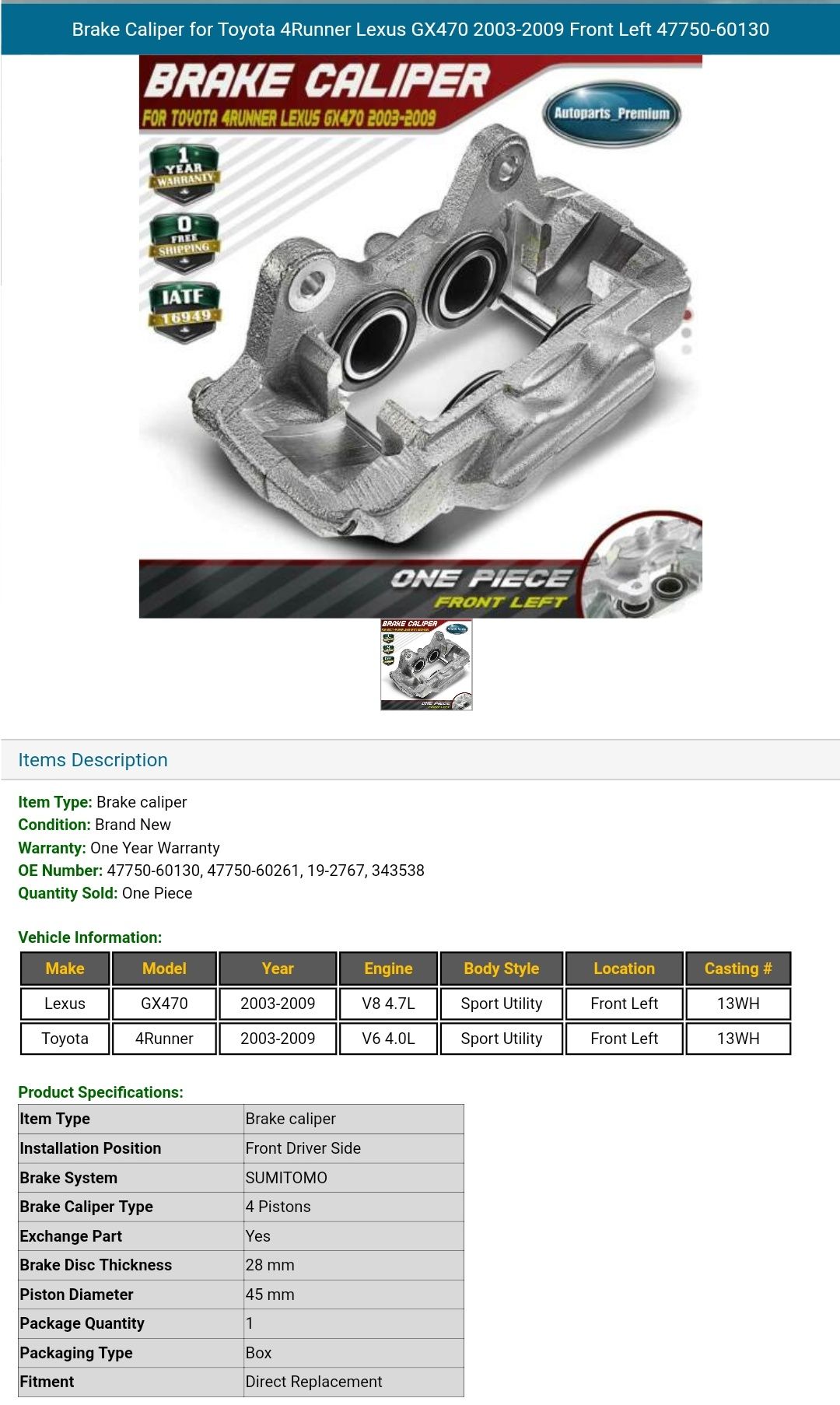

I convert mine to 150 series front caliper. Rear is same so no need to upgrade. Total cost when i did mine was less than US$500
I use silver zinc coated caliper from eBay.. Its brand new and still looks great after a couple of years.
The caliper piston are about 14% larger. In theory You would need to press deeper for same piston travel, but the upgraded rotor and pads grab so much better than my worn OEM brakes that i do not feel any different.
The rotor are 4mm thicker for 150 series and resist fade much better.
View attachment 2209760View attachment 2209761
