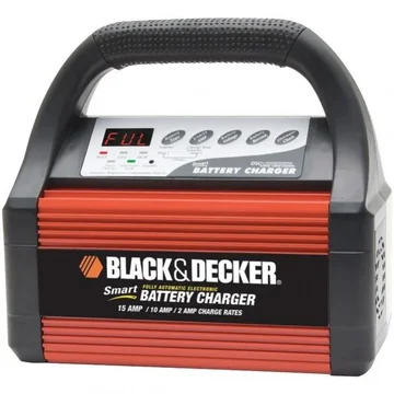

Charging in parallel won't solve your problem. What you can do is use a smart charger that can equalize the cells and recondition the (abused/molested/drained) battery.
I use a B&D (it's the only one available in my area) for this with good results but there are other and maybe cheaper brands on the market.
Rudi
Hi Rudi, thanks for weighing in. I am going to keep plugging at them with my fancy charger- essentially the same as yours. My partner & I are looking at relocation possibilities and Costa Rica is high on her list. I may want to pick your brain off the thread if you are willing. Thanks,
