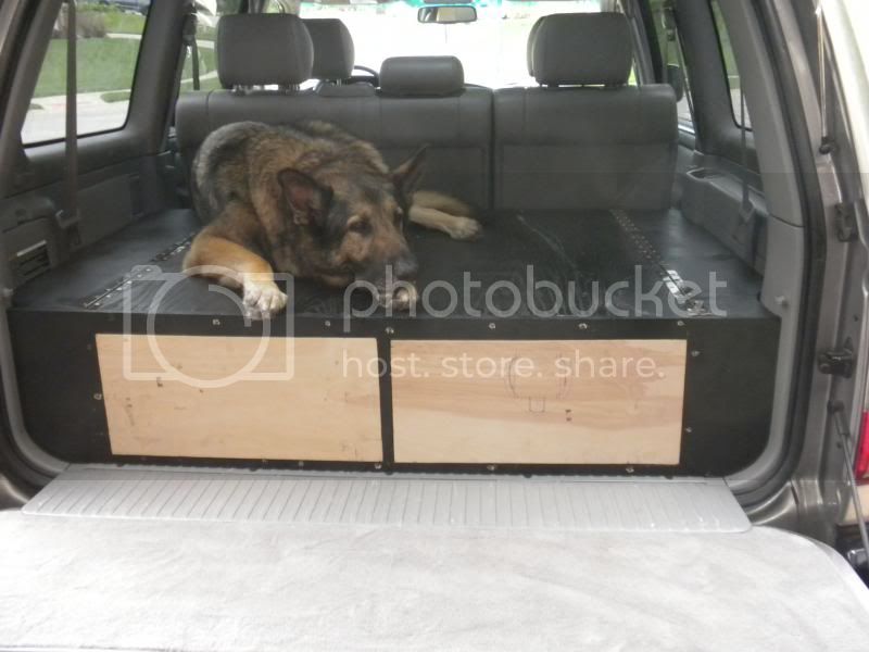

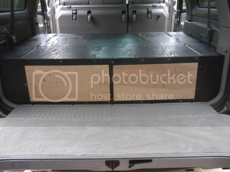

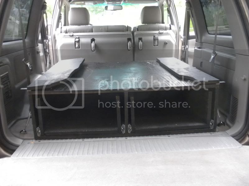

Spent a good bit of the weekend working on a drawer build for Manny. 3rd set that I have made, everyone a little different.
Still some work to do (Obviously) but time for a beer and a cigar.
Most importantly, DOG approved :)!

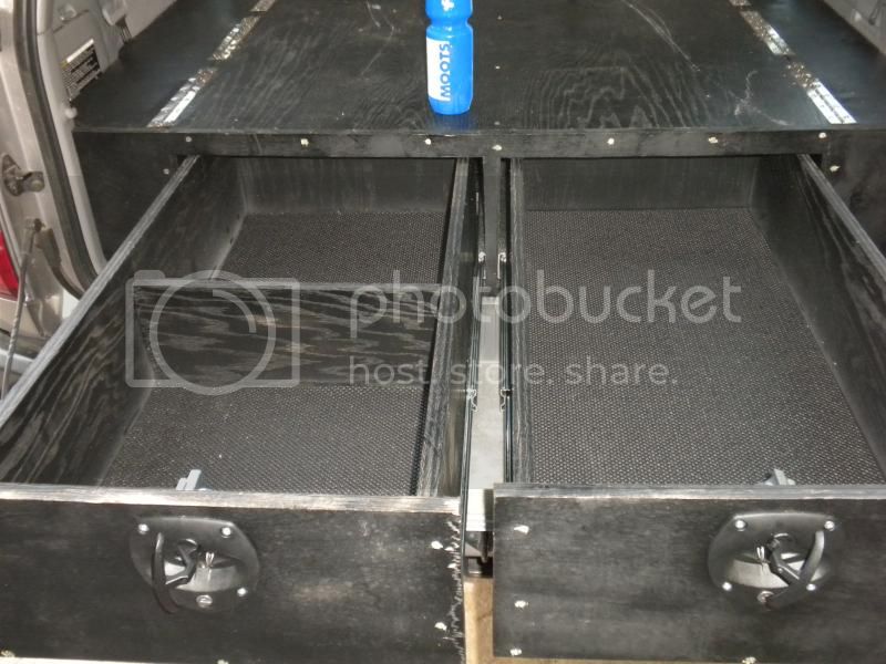

I need to go back and look, but I think they were 24", 200lb slides.
The latch will keep the drawer closed. For holding them open, in the past I have used a metal pin the went through the top and into one side of the drawer.
No I'm sorry, I don't. It is pretty heavy due to using all 3/4" plywood. My wife and I lift it in and out as needed.
You could make it a good deal lighter going with 1/2" for the drawers and top.
@gearguywb Is the only thing your using to secure the drawers the metal tensioners? If so, how many? 4? I assume that is so you can easily remove the drawers if needed.
