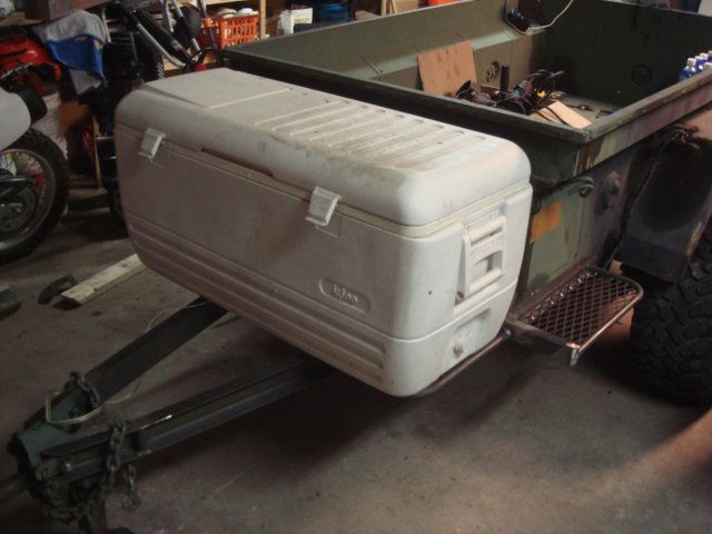

The water tank location is bothering me a bit in regards to the tongue weight, I would love to have it slightly forward of the axle but it cuts into the bed too much i think.
I'm also thinking of trying the tank in the flat position towards the front???
It would be nice if it was a little smaller to put it under the trailer but this one is too big for that.

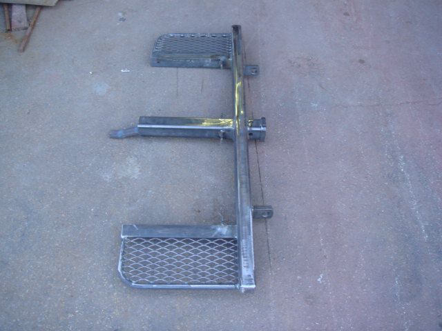

So i got the new longer shafts in the front over the weekend and a wee bit of fab work on some extra storage shelves.
The front one is not finished yet but will have the same material as the side shelves...
Everything is attached with bolts and can be removed which i will do when i finish the fabbing because i want to podwercoat or maybe Galvanise it for durability.
