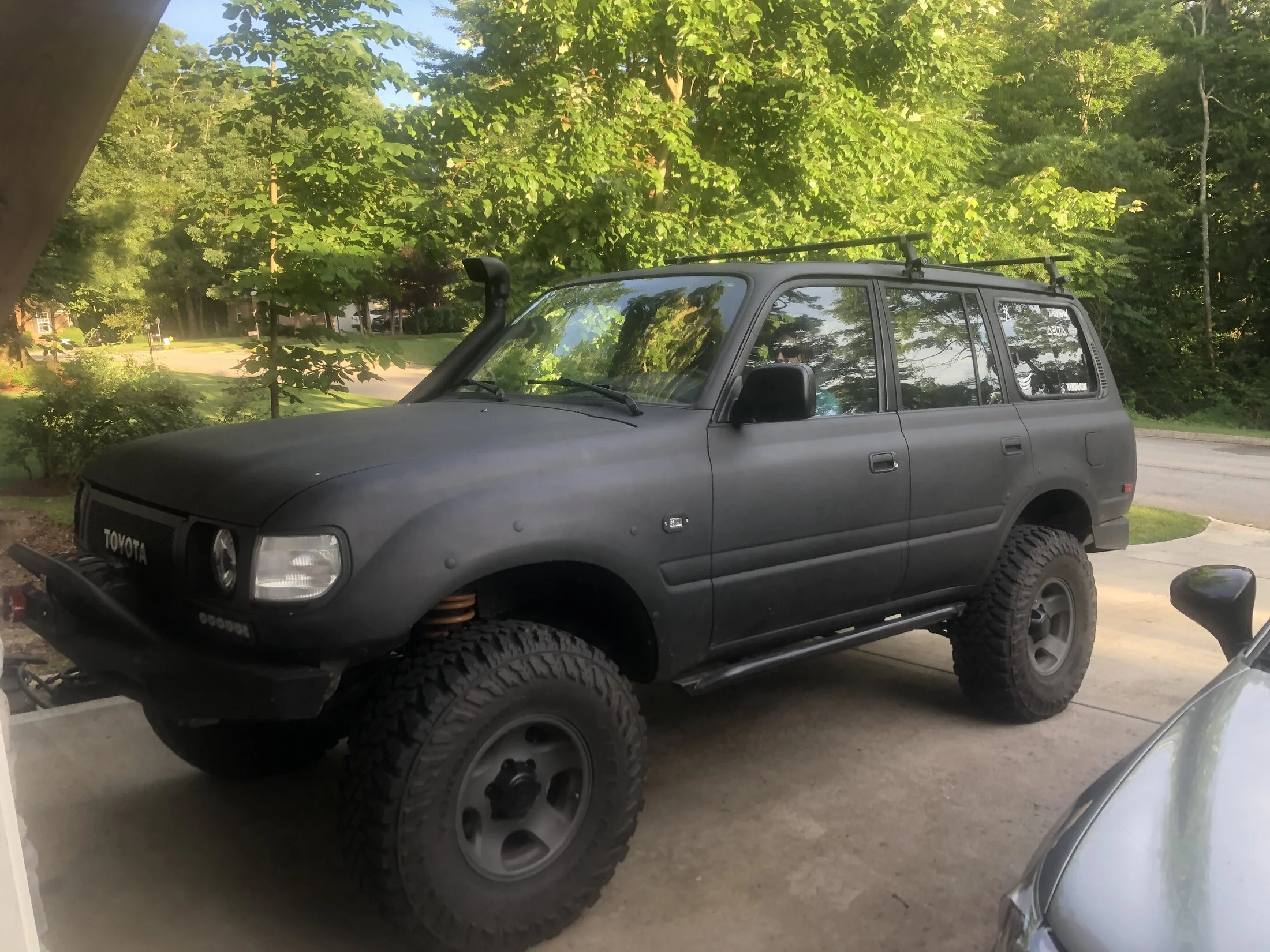

I took my rails off but they are probably tall enough to clear the rails. I’m out of town or I would measure mine for you. This pic shows them on my 80.
Definitely run some kind of a gutter mount. And I suggest deleting the rails and addressing any rust underneath them.
