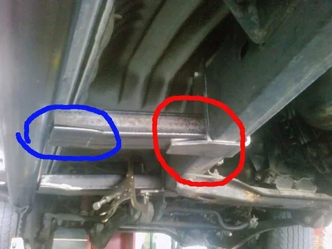

I have built a few sets with that same type of frame mount. If I had to guess the part circled in blue should be facing up toward the pinch weld. In my experience if you stack the arm on the bracket (like the part circled in red) the arm will contact the pinch weld when they are tightened up.
