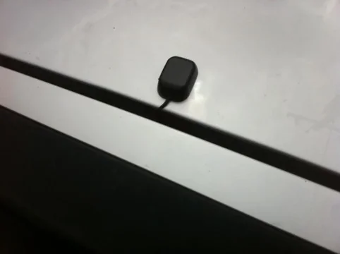

I tried to cut corners and have my antenna in the truck... Bad idea. My reception went from s***e to awesome simply by putting the antenna where I knew it should be... on the roof. As I stated earlier that's the design of this type of antenna.
Mine is mounted in front of the hatch... the black you see in the lower part of the image is the rear wind deflector.

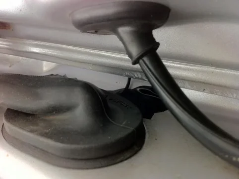

I routed the wire into rubber grommet and ran it down the headliner to the area where the jack is, where my XM tuner is located.
