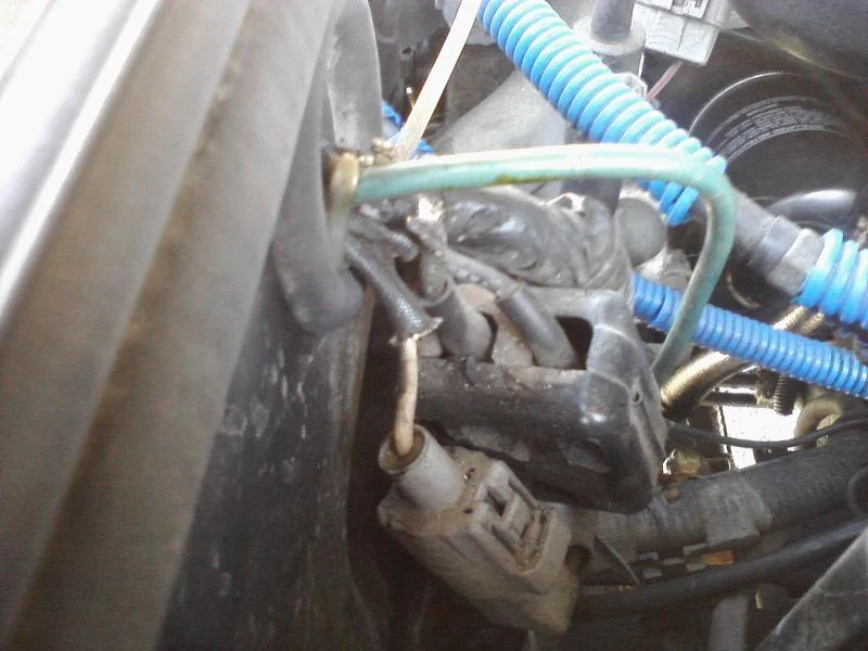

Just went outside in the cold and looked around. There is a short circuit on the ground battery terminal cable. there is a small pod marked "AM1 main" connected to the -ve terminal, has 2 wires coming out. One of those 2 wires (looks like size 14 AWG) was fused to the negative.
I wonder what connects to that...
pics
from the cell phone camera
That would be the main fuse I believe, and it connects to + side though.

Sorry, I meant +ve side of battery. One of the symptoms when this happened is that the power to the shift lock ECU was gone with the wire shorted. I had put the car in P. Had to get creative when the tow truck arrived. Luckily I had a screw driver and Toyota has a manual override mechanism near the shifter.
