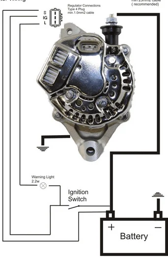

Hi,
I have to following setup in my car (1hd-t) to charge the battery.

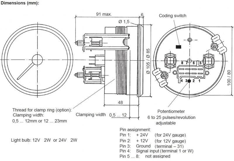

I also have a VDO Tachometer 333-035-003G
As
I am not an electrician,
Is it possible to wire this tachometer somehow to the alternator?
Or should I look for another solution?
